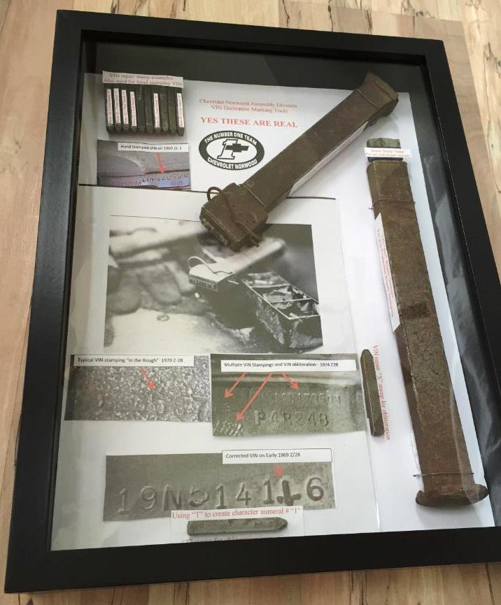

Here are Examples of Factory Stampings.
First is the Original Muncie , late build,
10 C &amp; 661 case with drain and fill.
69 Z/28. M 21.
the '777' vin stamp is Actually *111*

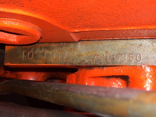

Second is an NOS 302 Engine Assembly
From the Flint Michigan engine plant.
Note Date # 7 &amp; letter capital I in lieu
of 71
