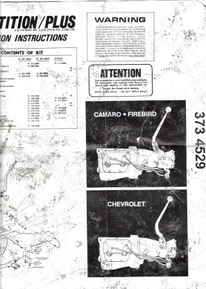

Default Re: New Hurst Shifter for Nova with Console
For my 68 BB nova with console I used hurst 3734529 shifter kit. I actually heated the bottom of the shifter handle for a small adjustment really just a personal preference. You may have to adjust it a little to make it work. Nothing like a hurst shifter gate.
That sheet I posted is from 2002-2003 when I did my 68 L78 car. I recently put a hurst shifter in a 69 chevelle with no issues at all. 10 times better than the stock Muncie assembly.
