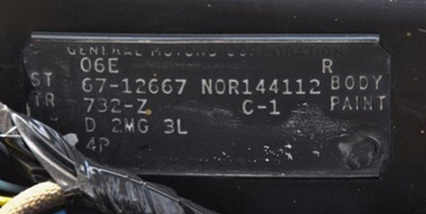

Gents,
Can you kindly support the decode of this cowl tag. I'm very nice to 1967 cars.

Bright Blue Custom Buckets No Headrests Power top, Power glide with a console, Rally Sport, and likely an SS.
Ermine White white top.

Looks like someone liked the Pace car enough to RPO order a car just like it.

Dead nuts to a pacer P would be SS/350

Why not a pacer? No O-1? No fleet number? I think there is more to it than that.

<div class="ubbcode-block"><div class="ubbcode-header">Originally Posted By: SuperNovaSS</div><div class="ubbcode-body">Why not a pacer? No O-1? No fleet number? I think there is more to it than that.
Jason </div></div>its because it was born in June.

I bought from original owner a white w blue interior 67 that was ordered as a copy of a pacecar copy for a 16 year old kid. His Dad would not let him by the pacecar that was at the dealership when they arrived, but he ordered a 6 cyl. copy !! It was a neat car.

<div class="ubbcode-block"><div class="ubbcode-header">Originally Posted By: SMOKIN_JOKER</div><div class="ubbcode-body">Dead nuts to a pacer P would be SS/350 </div></div>
Could be an L30/M20 equipped car too.

Obviously this one's not but of note, the first '67 Z-28's and L78's had 4P tags too.

Pretty sure a 2M with 4P is 2 sp powerglide with 350 eng. Couldn't be
A L30/M20. Doesn't have the 2L for 4 sp.
