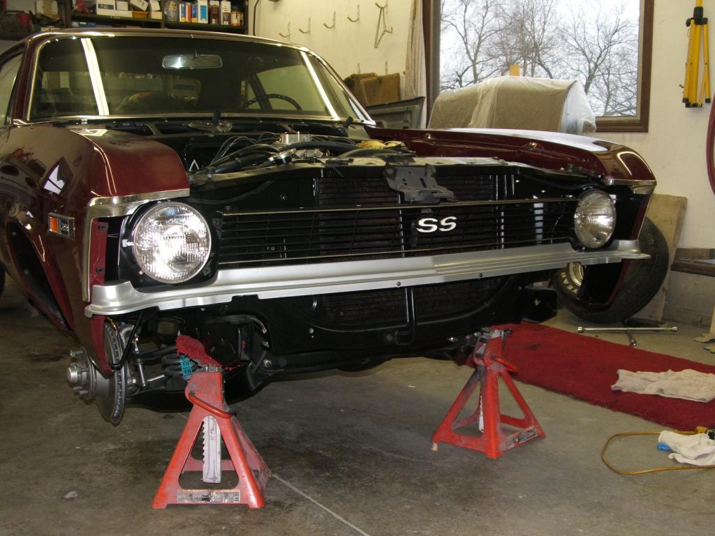

On the top side of the front bumper has the filler piece. Need to know what the proper color is of this so the body man/painter can get this finished in the proper color. I know its not the body color.
I thought it was Argent Silver or something like that.
Thanks for your help in advance.

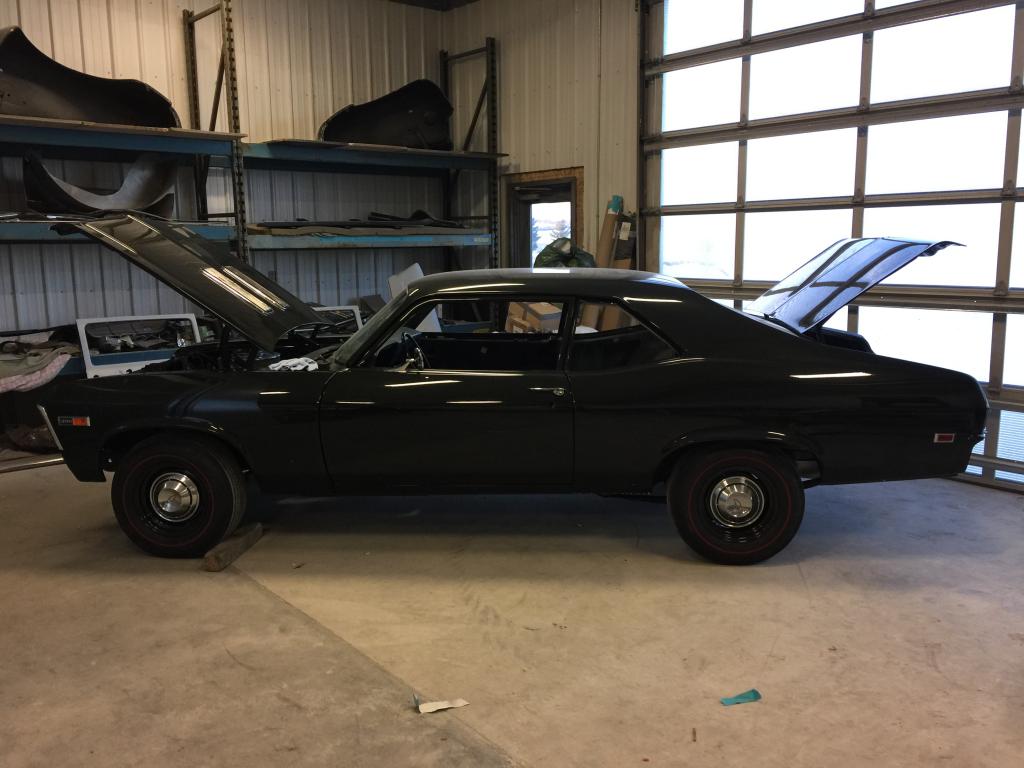

Things have progress pretty good. Fathom Green looks pretty dark in that lighting, but is the code as provided by a local member here.
I will let the bodyman/painter know it Argent Silver. Thanks for your help.

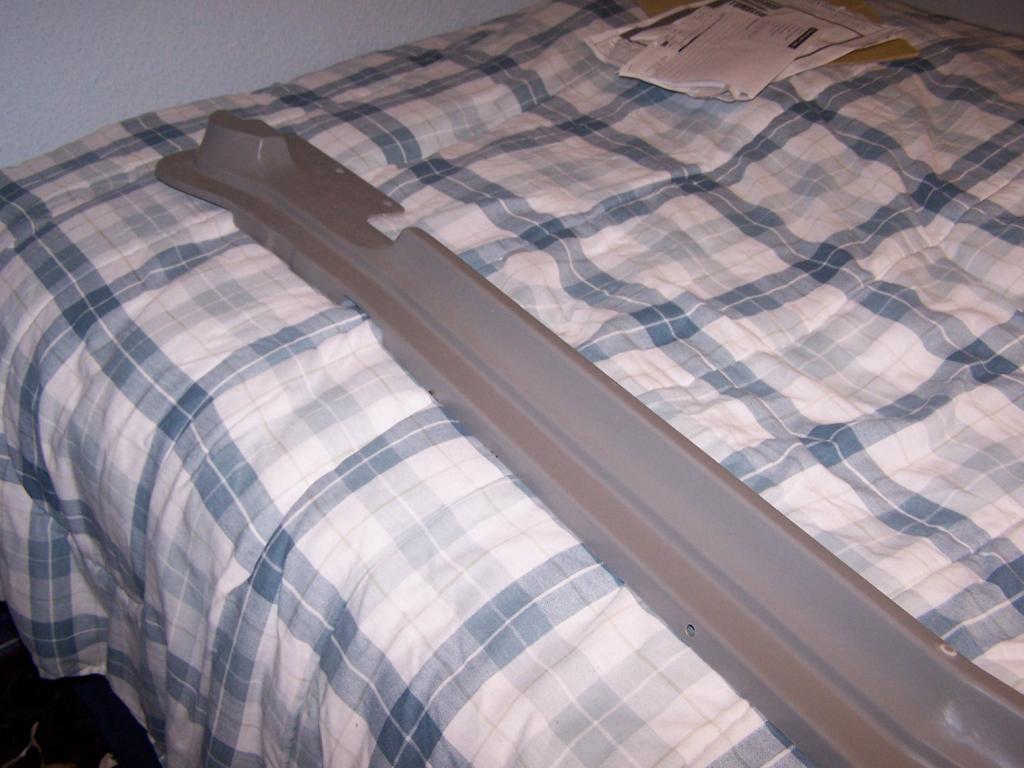

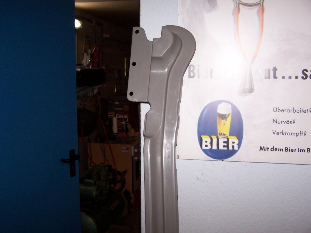

I have two NOS 3919083 fillers. Both are silver/Gray, can't tell, AF Docs said I'm color blind. Anyway, could the correct color be the color out of the box? Here's a few pics from one of mine:
