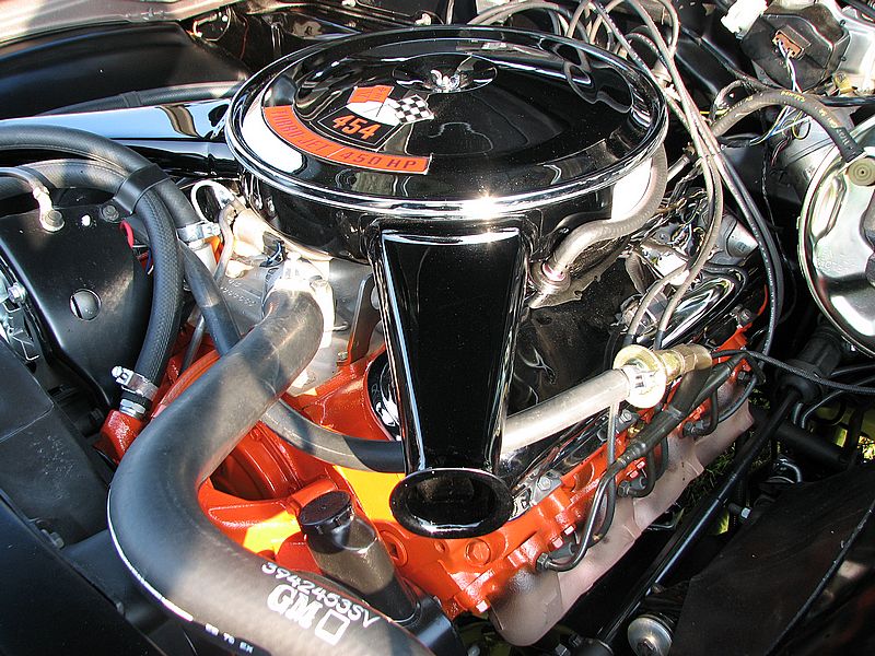

Don't know if he's corrected them but the hose markings Pace Car Jeff was using is unlike any original GM 70 Chevelle BB radiator hose I've ever seen. Do you need a 3942453 SV upper or a 3917227 KY upper? All BB Chevelles use a 3959188 SZ lower. When I asked Jeff where he got his sample from he produced an example of a totally different application than these 3 numbers I've listed as his reference. I'm not intending this to sound like a vendor bashing but if you advertise exact reproduction anything, I feel you better do your homework before making that claim. There are more accurate stamped hoses available for 1970 BB Chevelle applications, feel free to pm me for more info.
Chris

I use Chris's hoses on all my LS6 restorations and they are dead on. Here is a shot of one installed on Mark P's car complete with date code and stripe.

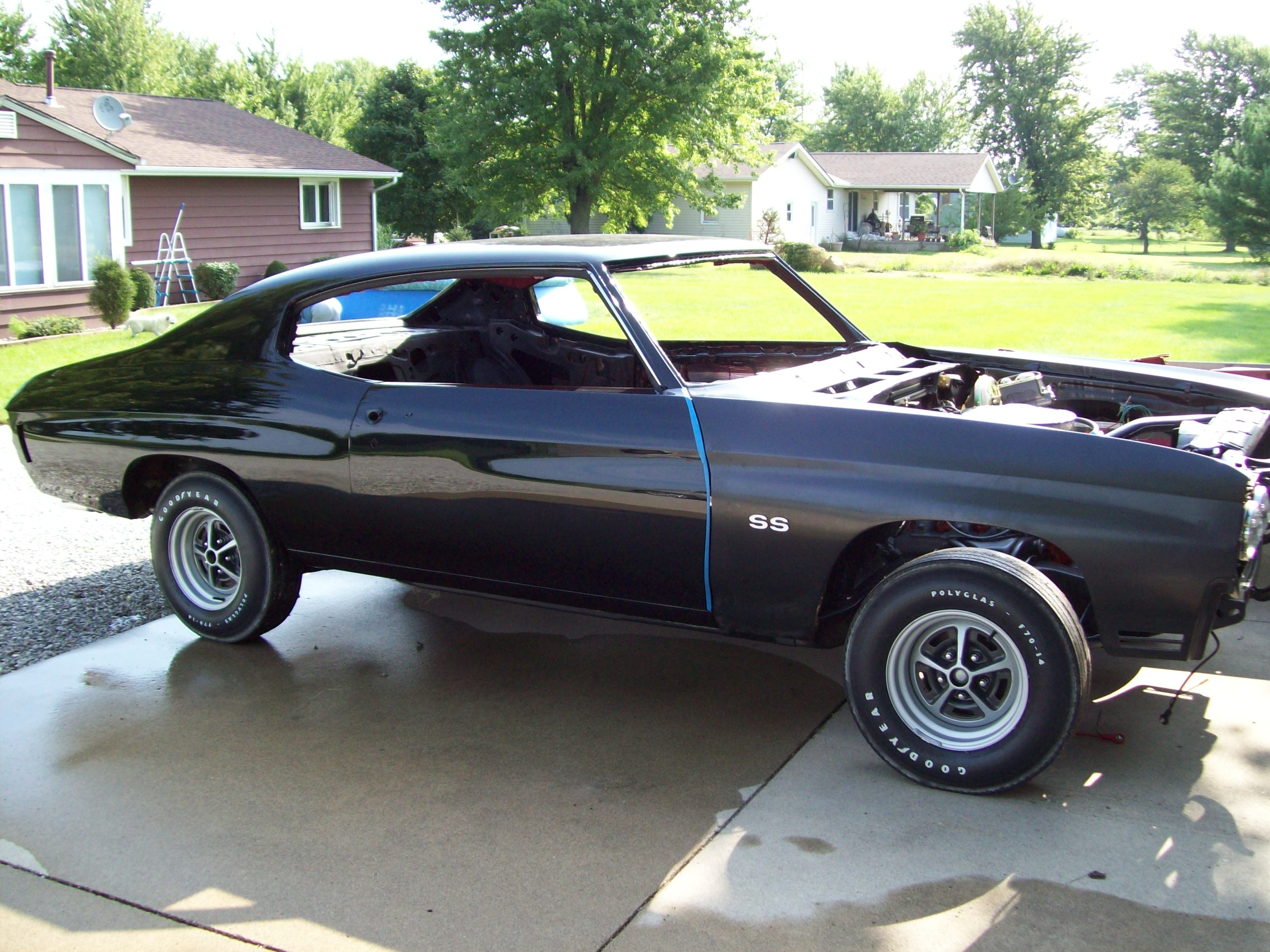

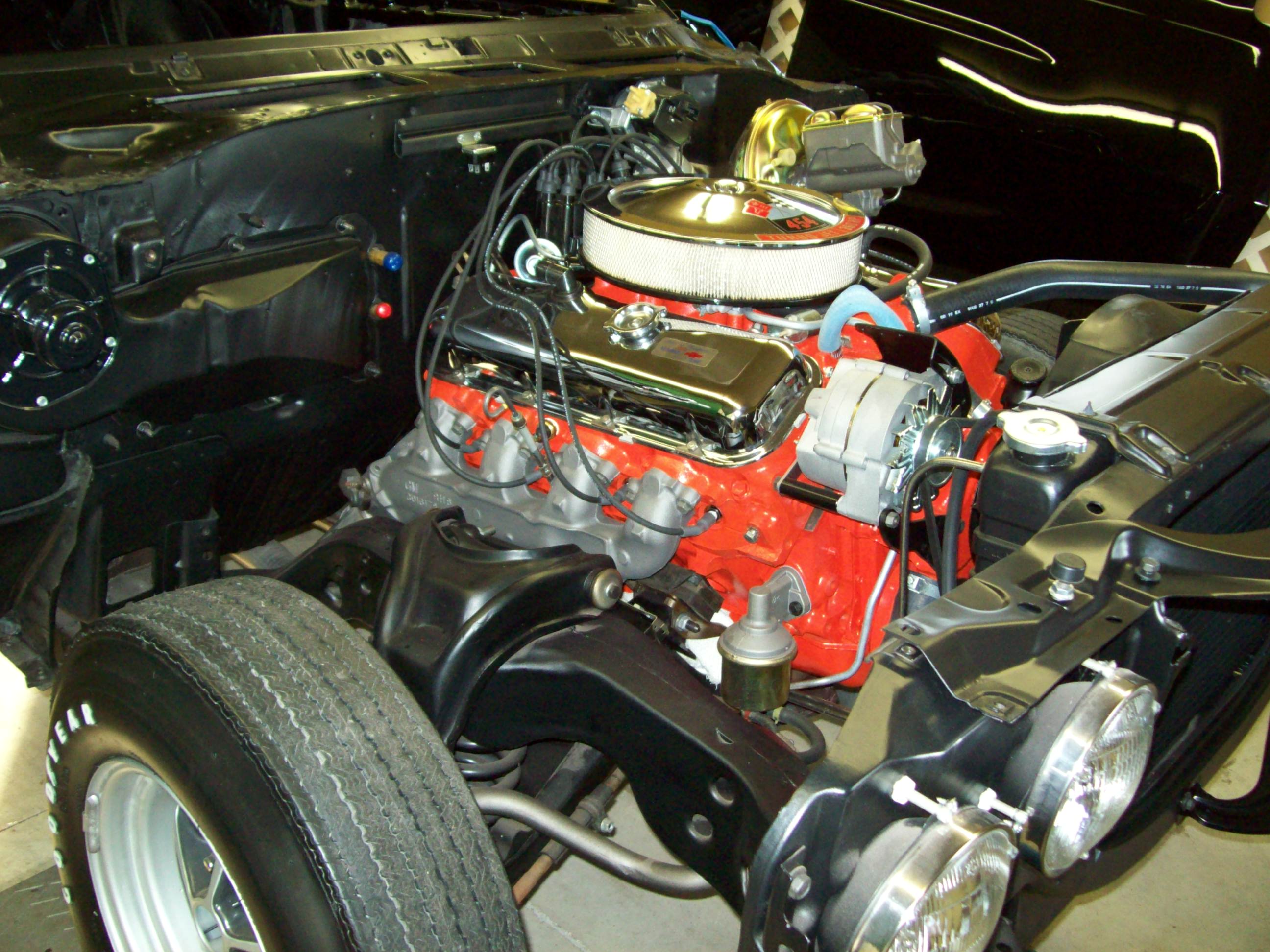

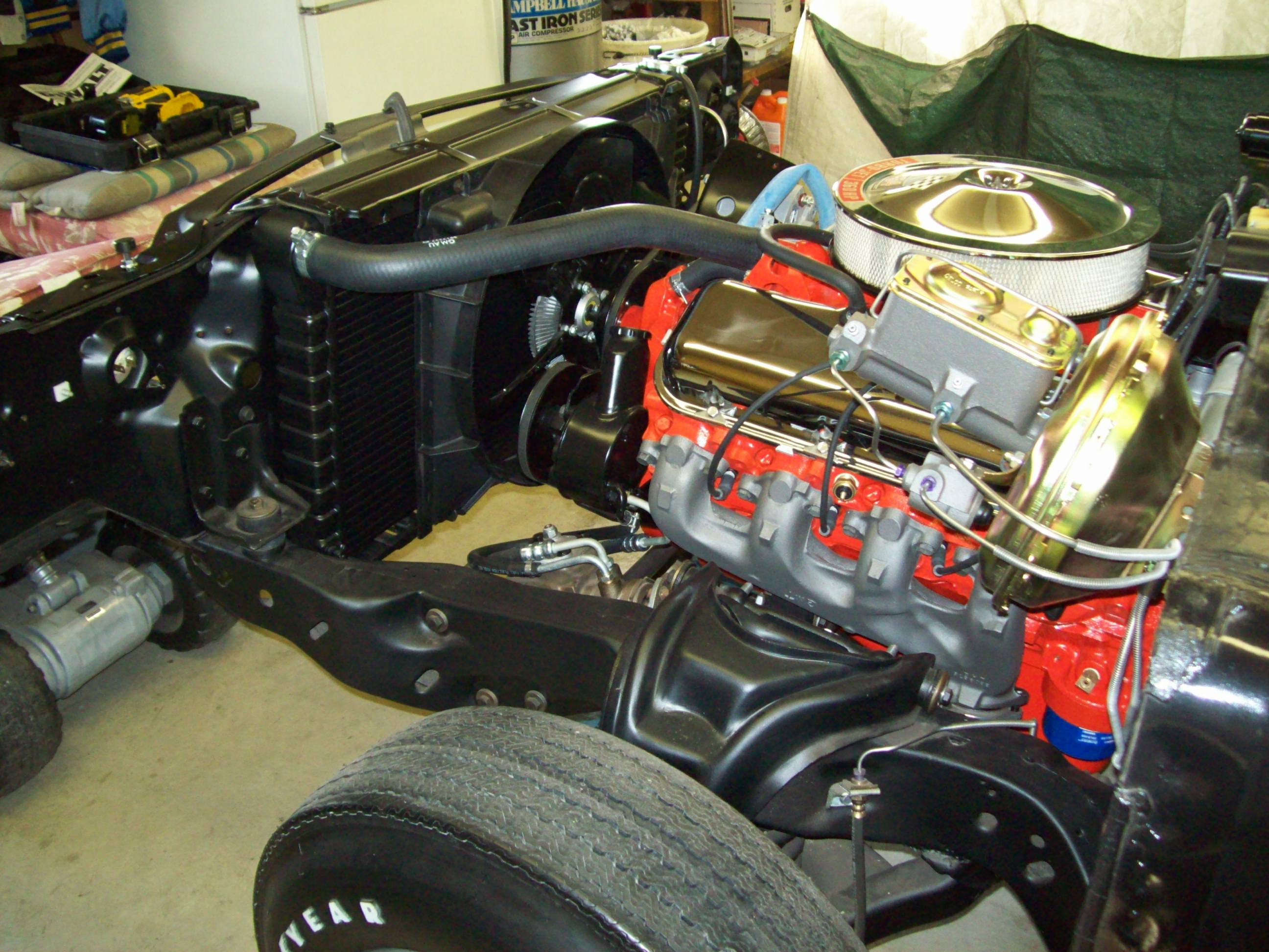

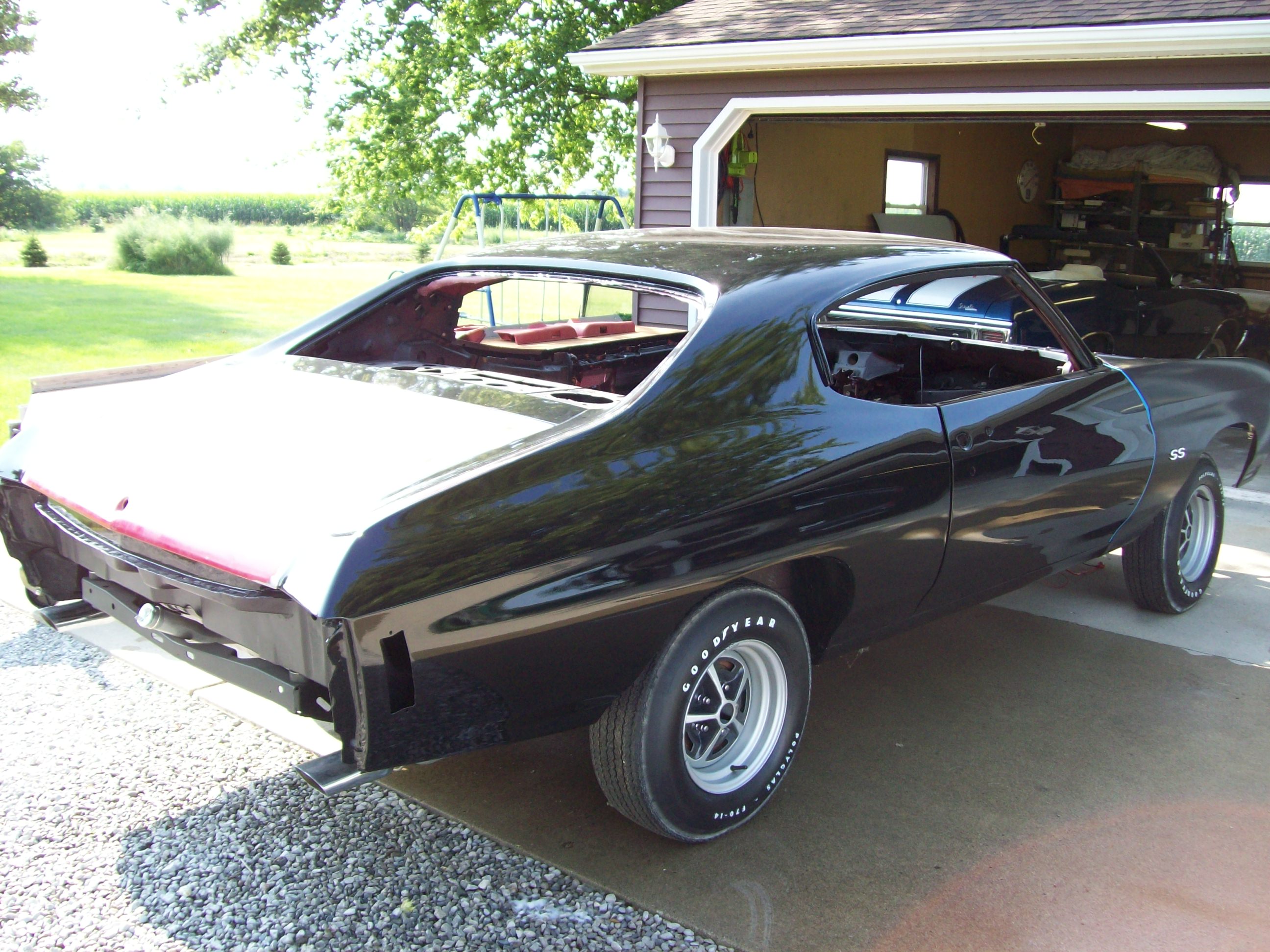

Here's a few shots I took recently. Fired the engine up a couple months ago and just got the rest of the sheet metal back from the painter. Looking forward to getting it finished up by spring. 20 years in the making....
