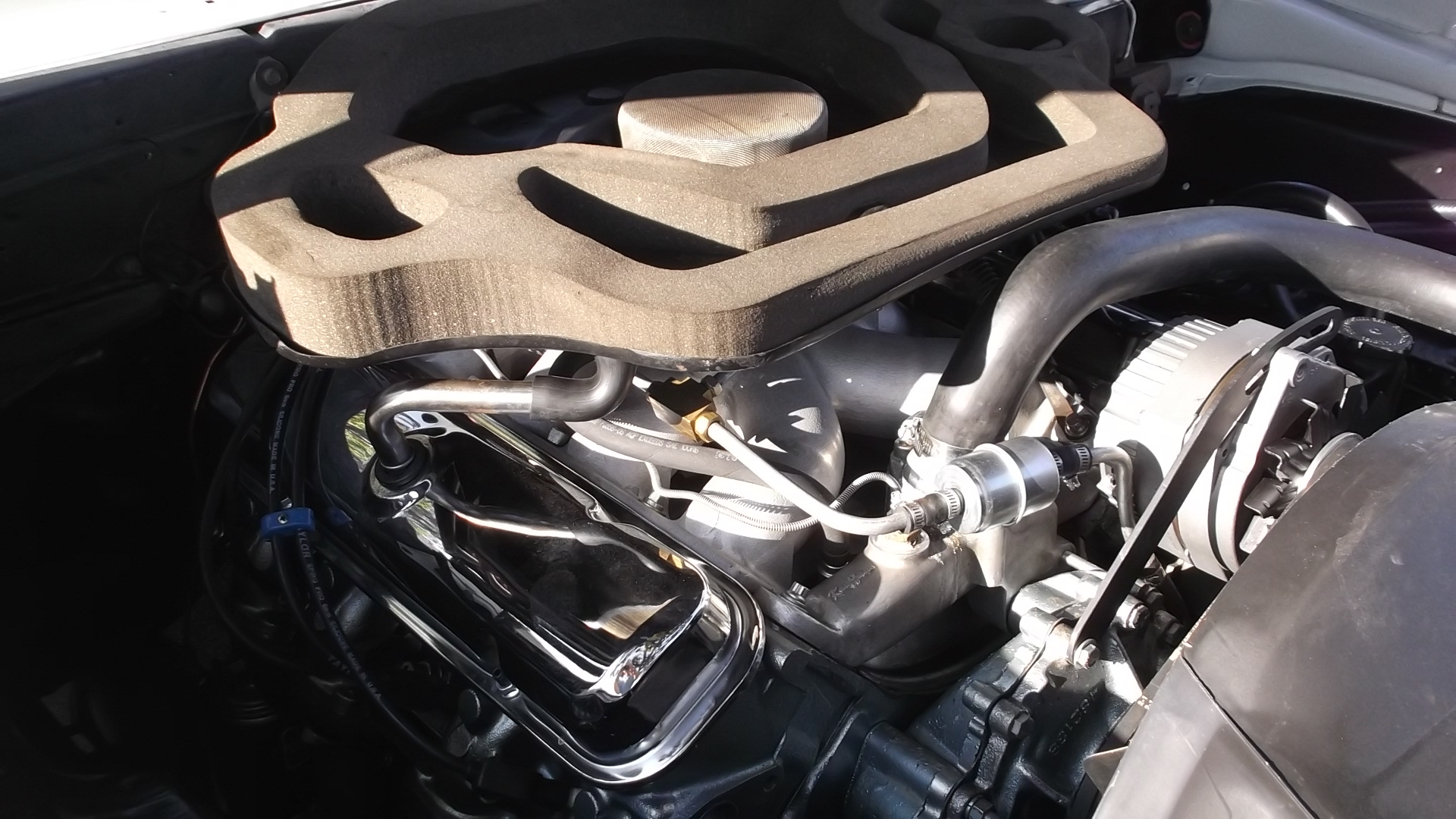

Old 09-11-2014, 03:02 AM
tjs44 tjs44 is offline
Join Date: Nov 2003
Location: long beach,ca
Posts: 957
Thanked 284 Times in 106 Posts
Default Re: pontiac 366 NASCAR Ram Air V engine
Here is a pic of the car and the engine installed.Tom
