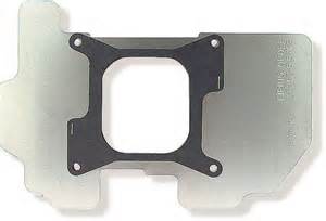

Dicky.....not sure of other year Camaros but the 1970 Z28 with Calf emissions RPO NA9 came from the factory with a unique heat shield that was very different than the one you have pictured. I'll post a pic of one below.

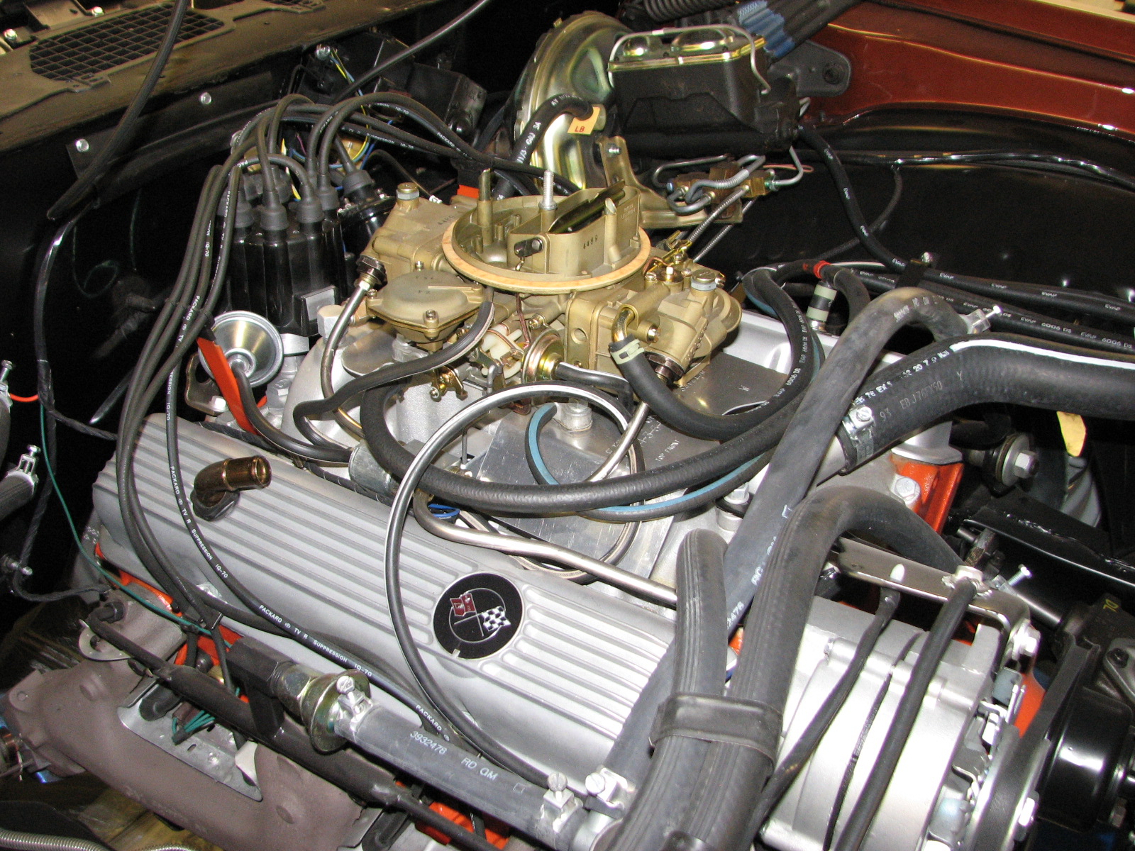

What it looks like installed complete with NA9 system.
