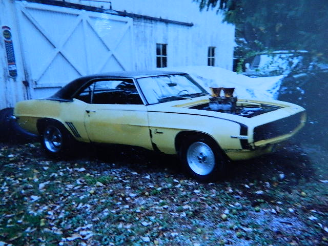

I used 2 450 Holleys I reworked. I picked a circle track solid lifter cam with high lift but mid range power designed for a 350 2 bbl
1967 Camaro conv (first car)
1969 Camaro street car
1967 Super Stock SS/JA Joe Scott car

Bentley, love that look with the velocity stacks, sweet. This pic of my Nova I was running a Edlebroch highrise, same as the Z28 intake with a 750 Holley and gold velocity stack, 30-30 cam, same as a stock fuelie 327 engine in 87-88. You can just see the stack thru the front opening. Love that look when I popped the hood. Always wanted to do a tunnel ram set up but I was thinking of just using a single carb for the street. I heard tuning was a bit tricky with 2 carbs. Did you have the covers that were available? I used one, kind of like the bug eye breather type.
