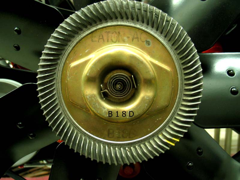

Warren, Great job on posting this info & pictures. I have a Nov 68 built 69-396-325 with AC. It has a Eaton clutch on it with an "AC" marking and a date code of "B18D". Highlighted in photo. I can't seem to find any info on it and if it could be original. It needs to be rebuilt but I don't want to disturb the original markings if it is correct. Have you or anyone ever seen an AC stamp on the clutch? George.
