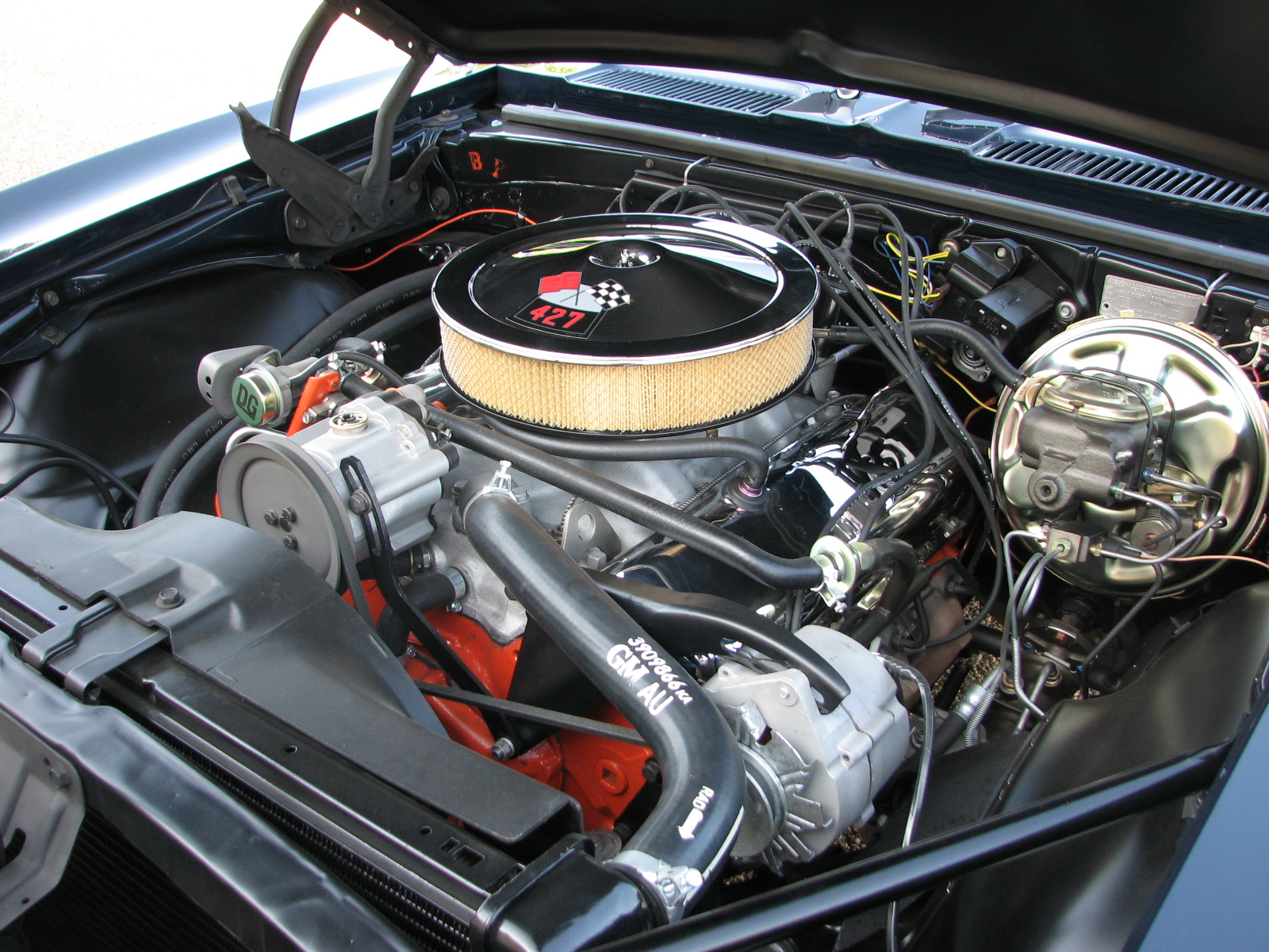

Paul, Steve Gregori www.brakeboosters.com is fairly close to you and he does a great job. I request a very dark grey phosphate and he always comes through. They also have a slight crystalized texture which also resembles the original finish. Unfortunately I do not have any hinge specific photos but here is an installed photo of Dana's hinges. I have matched this finish to a pair of NOS and they are pretty damn close.
