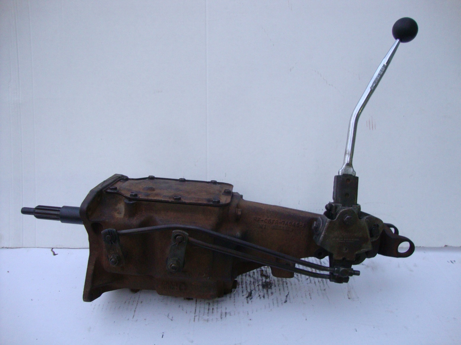

The GTO 3 speed manual transmission was based on a Toploader Ford unit. Here is one I recently had.

Pontiac had to buy 3-Speeds from Ford because GM hadn't any that could handle the torque.

In 1969 the GTO used the toploader.
