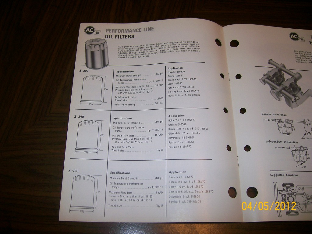

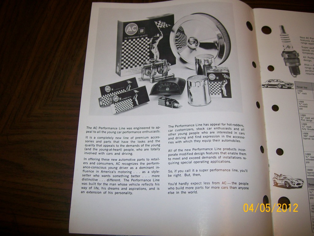

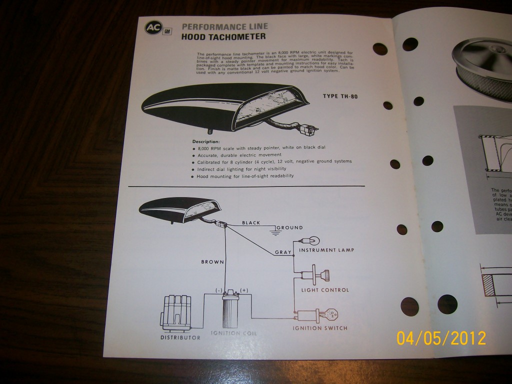

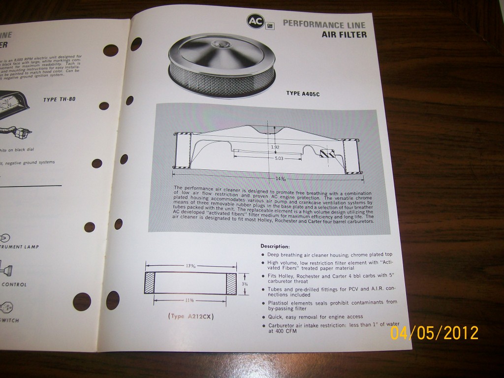

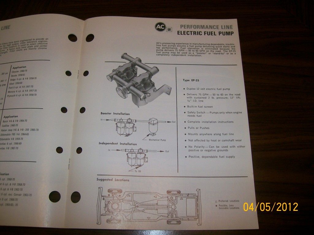

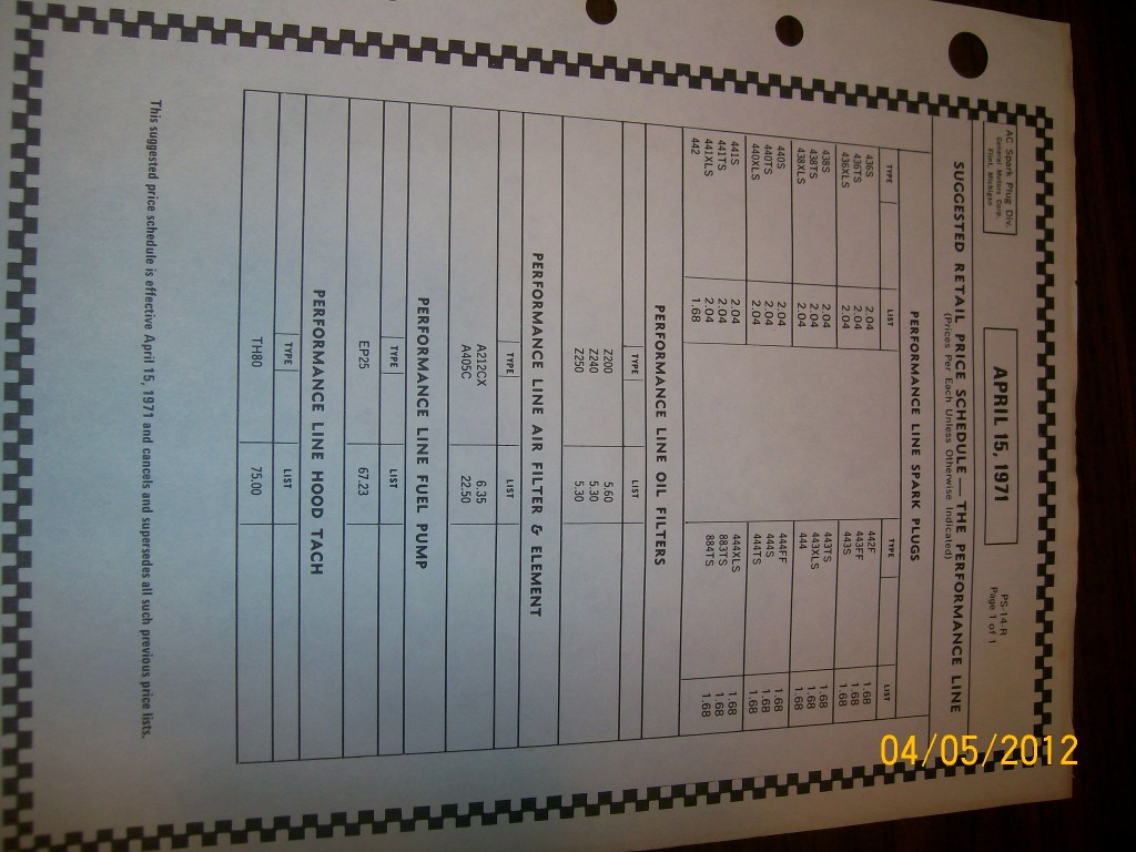

Here is the AC Performance line catalog circa 1971.
Brian

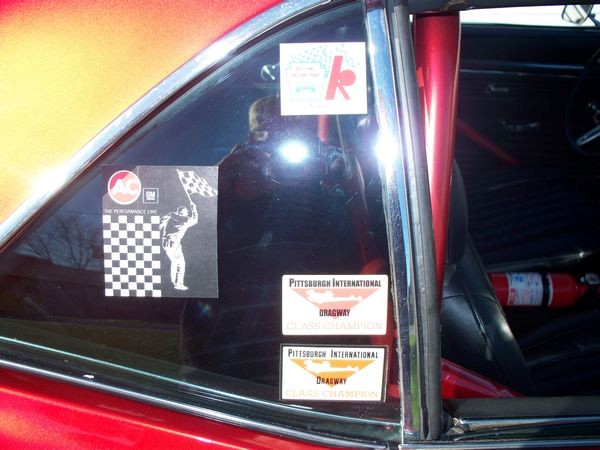

My Camaro has that AC performance logo on the quarter window!

A tough decal to get!

pictures of the filters, the a212cx is a a212cw, looks like they just took a heated X and burnt it on. The box looks like it is dated 1967 and on the box it also has 400 428 hi perf engines 1967, see all pics ??

From my old parts days, I recall some older A212 filters came with chrome wire mesh on the outside. Sorry I don't have a catalogue to confirm it.

I recognize these as the ones you sold about 6 months ago, last fall or so, original equipment on one year GTO, others it was the perf line filter, added screen on the outside and the big over molded X.
