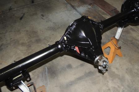

I know I am not on par with some of you pros, but wanted to share pics of my progress.

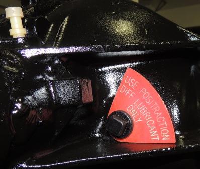

Got the rear axle rebuilt. 4.10 gears, new clutches in the posi unit and all new bearings. I have no idea what gears came in this axle, as it had no code stamped on it, and never has. Kurt agreed with my assessment that it was probably a warranty replacement. Just bought a set of 4.88's for when I really want to have some fun. I doubt it is the axle that came in the car even though it is dated July 28 and my car is an 08A car.

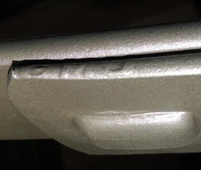

I realize I could have purchased some very correct looking rear springs, but want to use as much of the original old car as I can. Besides, these originals were not in bad shape, and they have that cool &quot;GMU&quot; embossing on the sides of some leafs. Even got one embossed area squeezed down where the leaf tapers.
Got the right silencers but couldn't find the right clamps. Everyone sells 1/8 inch thick clamps. I measured my old ones, and they were thicker than that. So I made clamps and &quot;rivets&quot;. Looks pretty darn good if I do say so myself.
I know the springs weren't painted from the factory, but they did have a distinctive gray coating. Besides, I don't want to spend a whole day sandblasting springs in 10 years, so I painted them a cast iron gray. Left the clamps natural and treated with REM oil.
Also blasted the entire rear and painted it. I like the Bill Hirsch (sp?) chassis black. Looks too glossy right now, but fades in nicely. I had no rust pits on either the rear or the parts of the springs that show, so I was very lucky.
Also used stainless fasteners to clamp the springs together, as those buggers have a bad habit of rusting out and letting the axle wander on the spring.
Ready to assemble, and make a roller out of this thing. Now, if I can just get that engine built.

Sharp Lynn! Found similar spring manufacturer's markings on my original '70 Nova springs when I restored them. Love the attention to detail! [img]<<GRAEMLIN_URL>>/biggthumpup.gif[/img]
