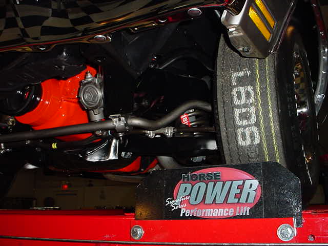

Made my own LEEDS stencil for my own tire & then set it on a turntable,using a lot of paint to squeeze into the tread.

Mark, is this what you are refering to? These codes can be found in box 93 of the build sheet. I had stamps made for these as well as a turntable to apply them. Note; the stamps were applied before the tire was formed so they go all the way into the tread. VERY time consuming. Code shown is L8DS 1 (used numbers 1-5)

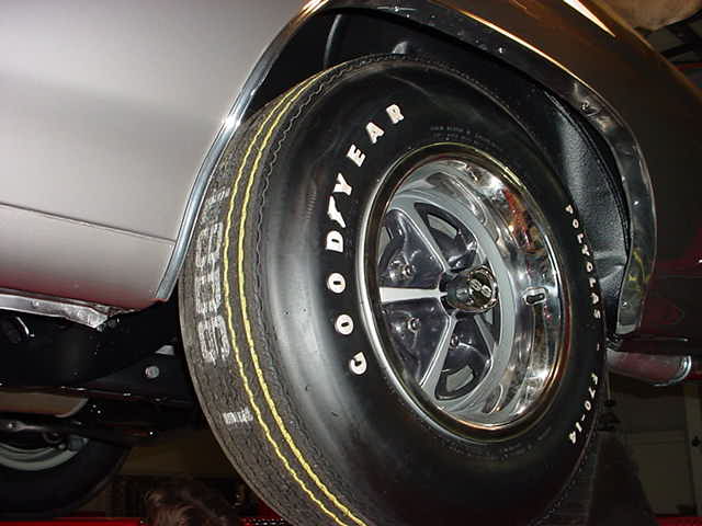

Here is another angle to show what the font looked like.

what does that decal indicate?? date, plant, production etc??

It was the code assigned to the tire size and style. It was called out on the broadcast sheet on the bottom of the chassis copy .
The codes were stamped on the rubber before the tire was molded.
