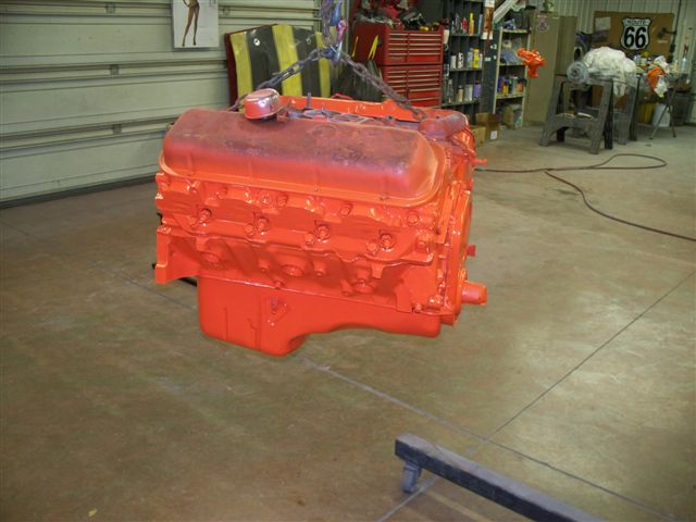

How do these look?...

After you fire the motor, and it gets the heat cycle cure, it dulls down to a nice flat sheen.
I shoot it through an old Binks 7 and thin it just a touch with laquer thinner. Do not let it set in the gun very long.

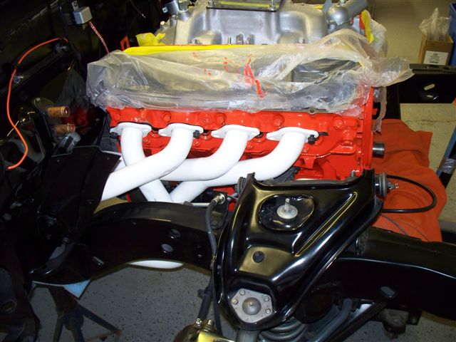

looks awesome!!!! what are the headers coated with and how will they hold up? thanx mike

The headers are coated with about 4 coats of VHT, each heat cured inbetween coats. I don't know how long they will last. This was a plan "B" after we had issues with the set we had planned on useing.
Personally, I like the finish better than the ones we had powder coated. JMHO.

Mine looked like that on the L79. I didn't cure them between coats. They sure don't look like that now after the first start up. More of a brown white. LOL...
Maybe curing them in a oven is the secret to holding the color.
