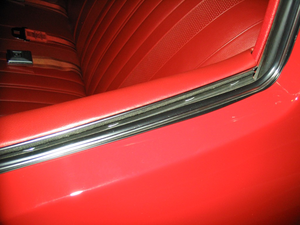

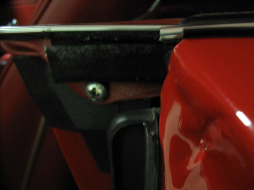

How were the window felts attached to the inside door panel and rear quarter panel trim? Any pictures plus a picture of an original quarter panel interior trim would be appreciated. Thanks in advance.

They were held on with 1/2" staples originally.
On the rears,a phillips head screw is used to fasten the beginning down also,near the windlace.
I can't share a photo of the front door panel felts,as they drop down a good 1/2" or so and are difficult to see once on the car,but they are similar to the rear.
