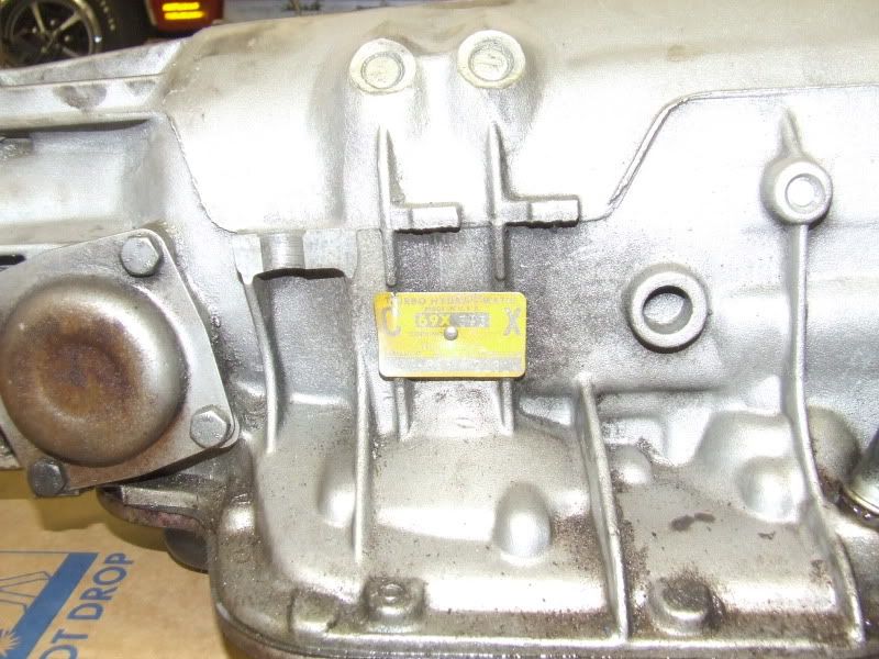

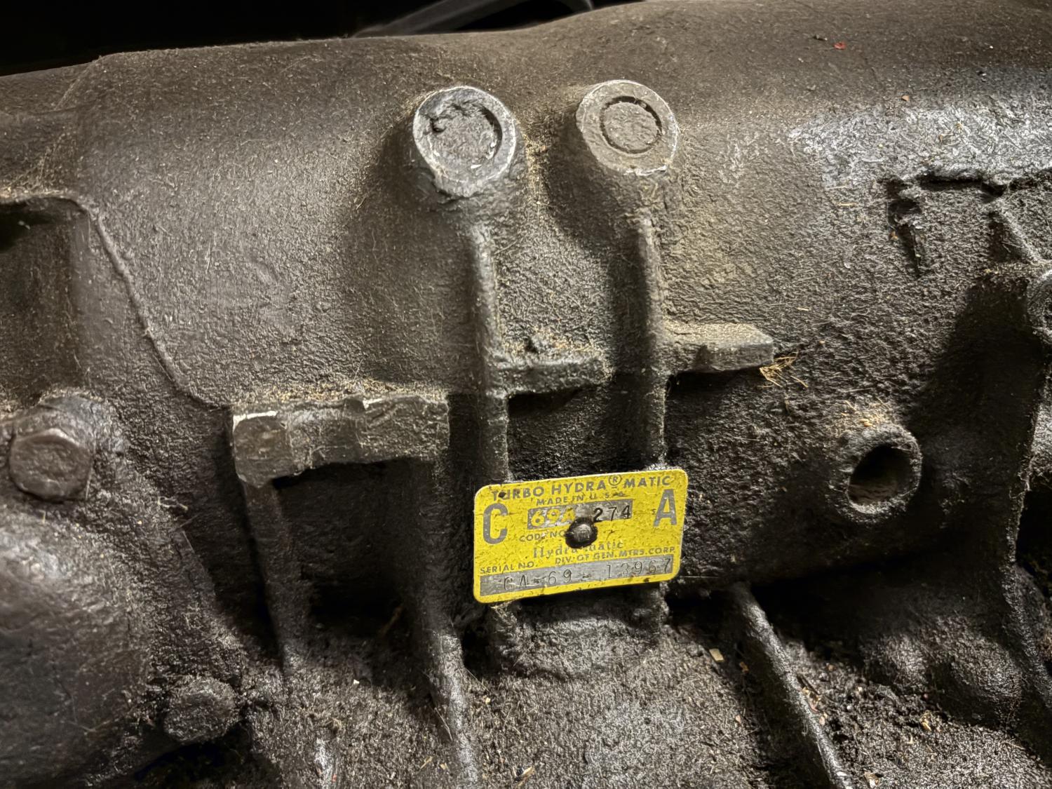

The 1969 hi po TH400 is CX code. Post the numbers on your trans tag on pass side and look for a vin no. on the vin pad on driver side just above oil pan.
