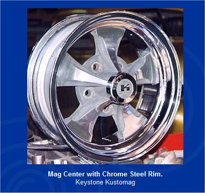

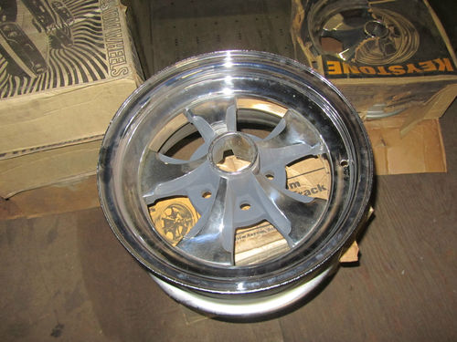

I just picked these old Keystone wheels last night. Before anyone tells me to buy new ones and swap the center cap, please note some of the differences.
I know some wheels the centers are the same for 14 and 15 wheels. Anyone know about these? Is there a down side on vintage tires for a 14"x4"? Maybe they don't make a set which lends themselves to a tall skinny front runner.
Brent, stole this from a post you made. Are these centers polished or chromed?
I really prefer the early gray centers. The wheels I picked up appear to have been painted black, at a later date.

Paul the center is chrome not polish . The center is painted grey not black. the 1 that's painted gray is dated 68 and the other dated 71 is black ?
