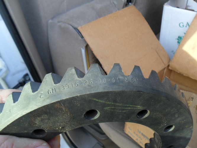

Had a closer look at the ring & pinion for my COPO Chevelle and realized they are both dated 2 67. These are the standard 3916226 / 3916228 gears. Has anyone seen a set dated this early?
Thanks,
Tony

date staper f... up...... should be 2 of 1969

Maybe you're right. Seems odd that the mistake would carry through to both gears though.

I just bought 2 nos 4:10 in the box. One was dated 2 67.

Well how about that. Same date on the R & P?

I saw a set for sale last year on ebay dated 1967.

Thanks guys, I guess it's not an uncommon date....

HI i know its a wrong stamp date with a 3916227 in 1967 all part numbers where 37ooooo part

The Feb of 67 date is a good date and it is accurate (not a mistake). I have a NOS set just like the one pictured above. It coincides with an ECN that I have.
I also have sets dated November of 67 and July of 68.
The earliest 3916234 posi unit that I have has an assembly date in the middle 1967.
Hope that this info helps.
