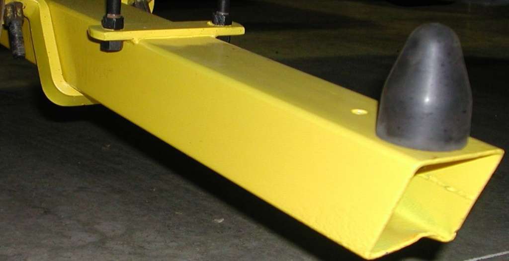

Old 08-31-2007, 03:17 AM
WILMASBOYL78's Avatar
WILMASBOYL78 WILMASBOYL78 is online now
Location: new york
Posts: 8,393
Thanked 2,250 Times in 597 Posts
Default Re: Day 2 Lakewood Traction Bars
Took some photos of the Lakewood's on our 70 car...
