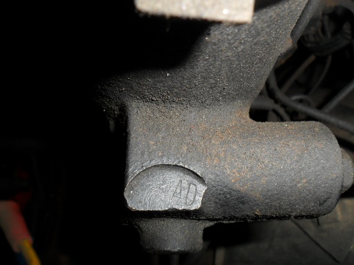

My 4K car does not have power brakes, but it does have disc brakes with the AD stamp on the master cylinder.
Check to see what the stamping is on the front small pad of the mc.
