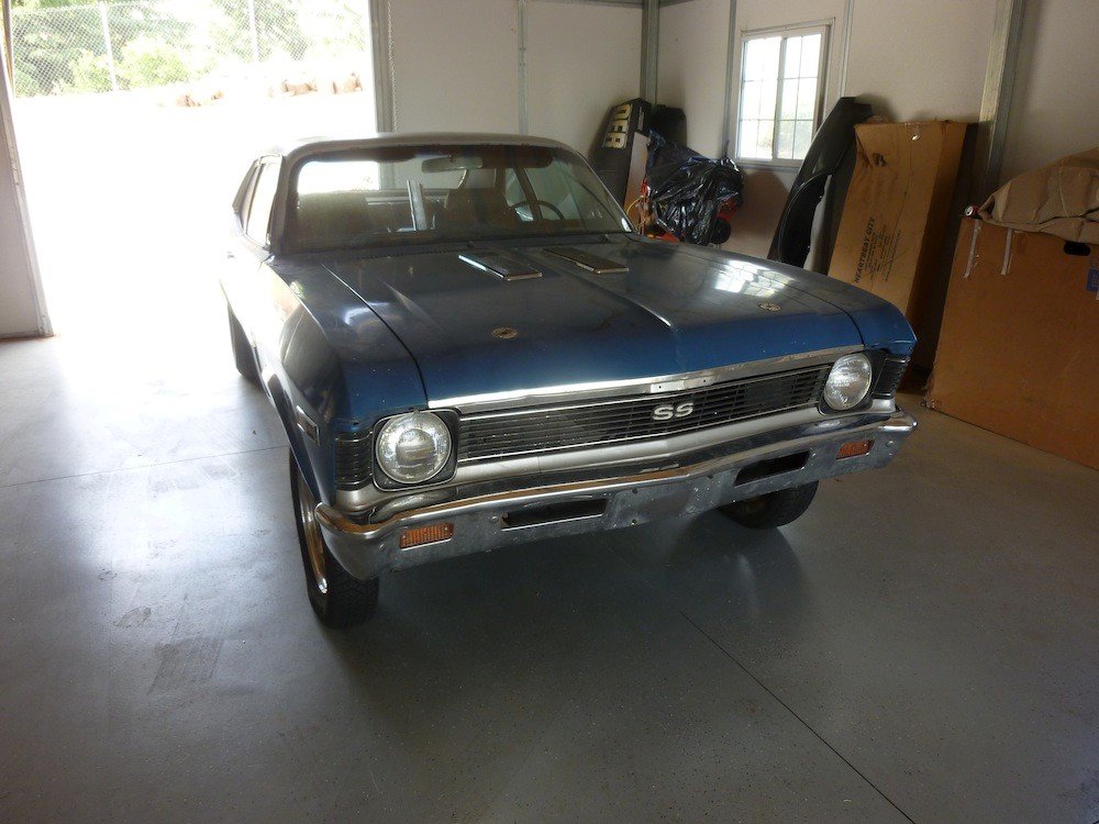

I just picked up a 69 Nova big block car. It is missing the engine but everything else is very original including the OO code big block radiator, the M21 trans, and the BT code 3:55 posi rear. I spent the day taking out the seats and carpet looking for a build sheet but had no luck. The car has a single 3/8 fuel line. Does that make it a L78 car? Are there any other identifiers for L78 vs. L34? It is not a tach/gauge car.

3.55 rear was the standard issue for all L78's...other gears were optional. The 3/8 line is a good indicator...any chance you can dig up some owner history..?? How about sharing some photos...thanks, wilma

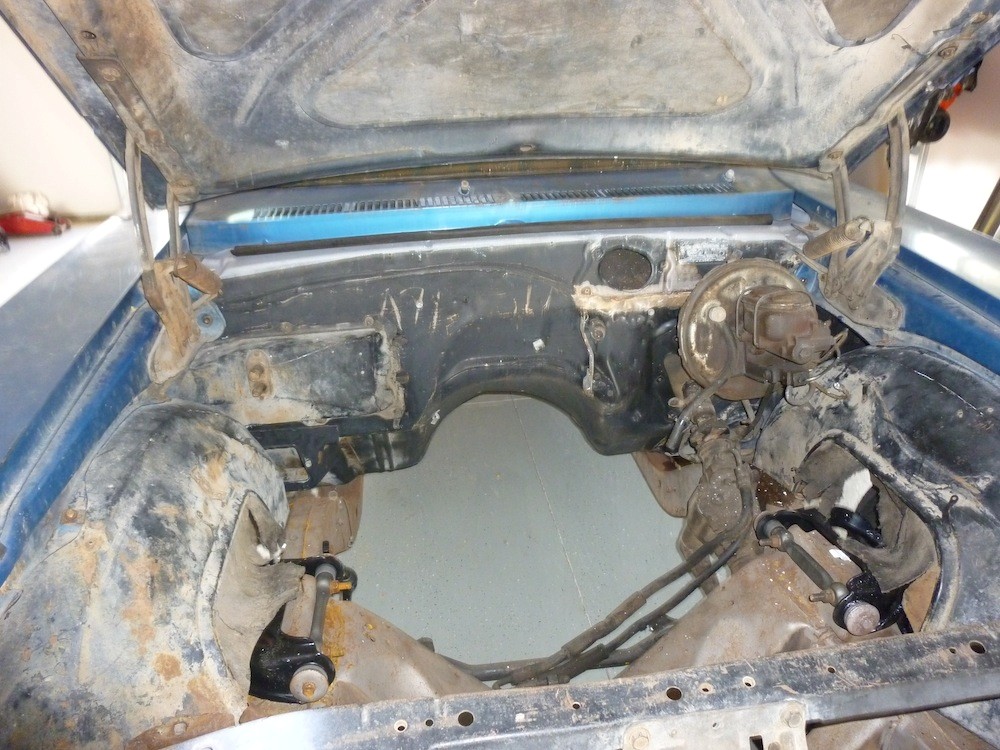

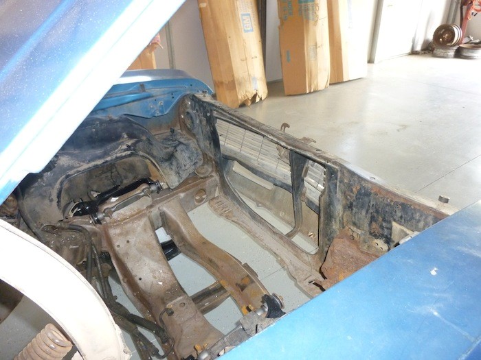

Here are some pics of the Nova.

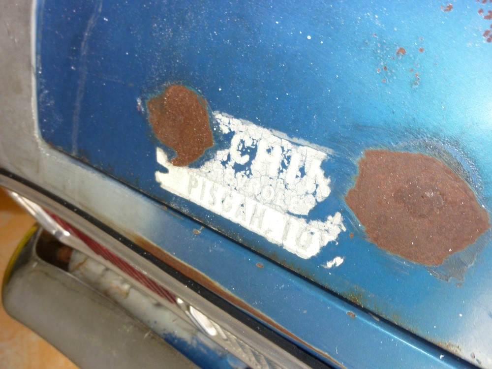

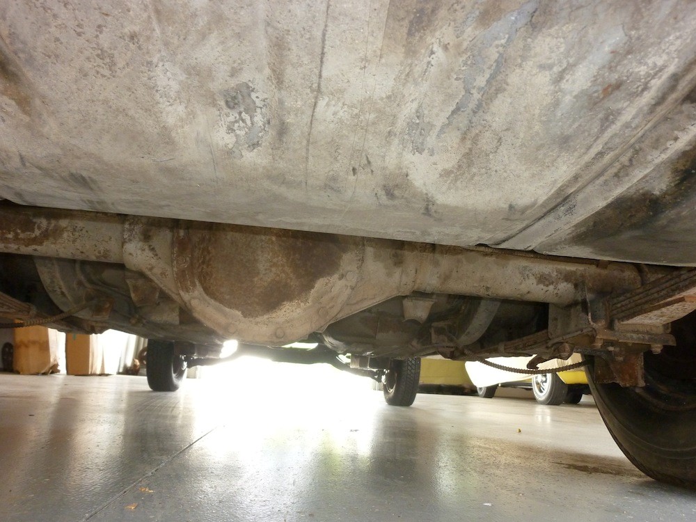

A few more.

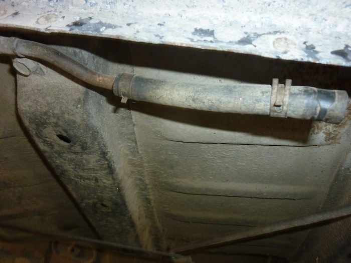

I see it had power steering did you get the pump with it if you did it would have a deep groove pulley. Take a picture of where the rubber hose comes off the line by the sender to see if its original back there

I did not get the PS pump. I'll get a pic of the line at the tank.

I like the 'A' '71' on the firewall, looks like another code is there too.
The single fuel line - and attaching clips - look original, (even has the non-safety rubber line clips), indicating an L78 version.

Was the frame removed at some point?? It seems bare metal??
And new upper control arms??
