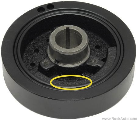

-----you should be easily able to tell if there is a 454 balancer on the crank by feeling for the counterweight on the backside......Bill S

Just feel for the lump
