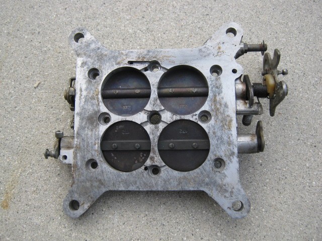

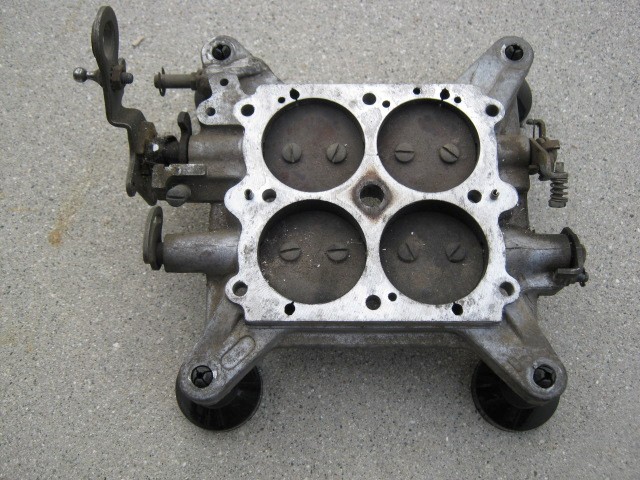

I recently purchased a 3310-1 and it had the wrong base plate. The cast numbers are 2R4233F and there are no stamped numbers on it. Does anyone know what carb models this went on?

I finally had time to take a couple photos. Throttle plates are 172s.

Looks like an early 3310 "EH" baseplate. The 3310-1 used a different casting with a flat machined boss on the pass. side rear corner that can be drilled to accept a PCV tube like the `66-`72 style 780's.

Thanks, I have a correct 3310-1 baseplate stamped 33101. It has the flat boss that you mention and a vacuum port out the rear. I'll just rebuild with that one and plug the rear.
