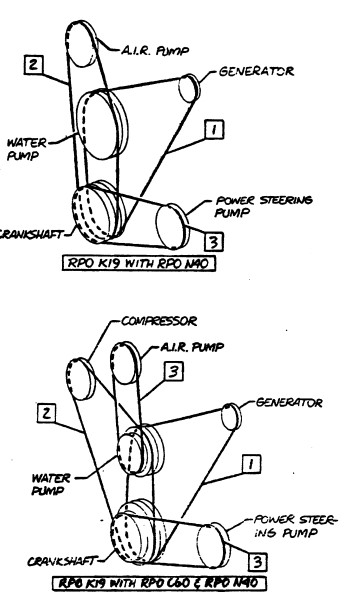

For "Factory Belt Routing" See your:
AIM (1967/1968/1969)
UPC 6
69 Los Z11
68 SS/RS 396/325
68 Los Z28
Last edited by 169indy; 10-17-2025 at 07:39 PM. Reason: I should have discussed the Pulley in question

don't forget there was also smog on LA cars

Was the power steering groove lined up with the smog pulley?

I’ll guess it’s the center groove.

So, la smog cars without power steering got 2 groove and with got three groove. I wonder if la smog cars without power steering still got 3 groove and it wasn’t used or got just the 2 groove? Does anyone with an original bb car with smog and no power steering confirm if they have 2 groove or 3 groove?
