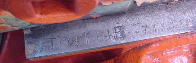

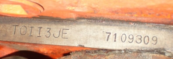

whats the thoughts on these engine pad stamps?
HI Vette stamps
Ebay engine pad stamps
Attachments - The Supercar Registry 453273-427vetteenginepadfromebay.jpg 453272-DSCI0130.JPG

Ebay stamping
placed below the first tag above

I would say that the first pic looks about 99% restamped while the second appears genuine. Need to check the broach marks with the heads off to see if they have been decked.

Pad on first stamp appears lower than the water pump (as in it was decked?)
Pad on second stamp appears at least equal to if not higher than water pump (as in it was not decked?)
