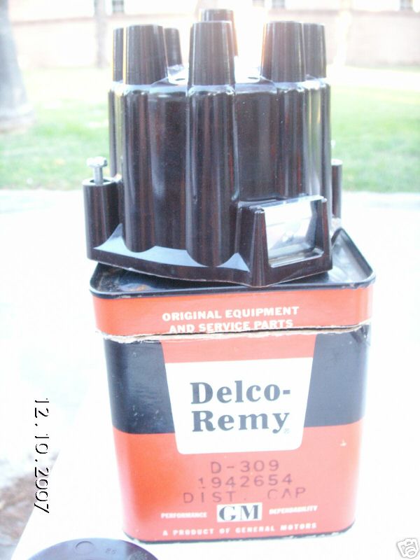

Here is the picture of one of the earlier style black and orange Delco boxes for a D309 cap sold a few years back. The cap was black with copper terminals.
John Brown
