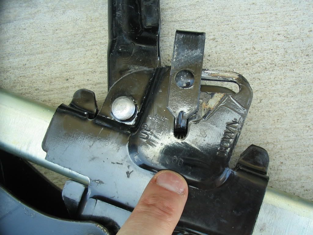

Were is the date on a jack for a 69 z.on what part of the jack.and how is it decoded.

Sometimes they didn't get stamped very hard and sometimes they did,and in various locations...such as this.
1970 April

so i would be looking for like a 8-k or l for a 3rd week jan car. 1969 z 28

You would be looking for 9A for January, sometimes they were stamped on the rivet. Sometimes they were not stamped at all. There are different variations of jack bases also, so there must have been more than one supplier of jacks.

so its not like other things where you can go a mouth or two back.that big sliver rivet to left of the picture.

You could,nothing was set in stone w/these.That jack pic I posted is from a June build.

Mine is on the rivot John. Endura Bumper car.(8L) November of 1968. I have an 11D trim tag.

how do you get june from od

I was referring to the car it belongs to is a June assembly.
Jacks usually predate the vehicles assembly date by many weeks,or months in some cases..
