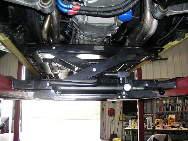

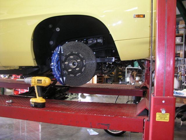

Get a 4 post with the sliding jack. You can change tires etc easily. When these things came out it really advanced 4 posts

How much extra is it with the jack app?

I can say only but great things for the new red/white/blue backyard buddy, and you can get the slider jack option for it like charlie shows in the pics. none of the purchase price goes to china either.

The sliding jacks are right at 500.00 and work great. They are on Ebay.. The width is adjustable for different size lifts.
