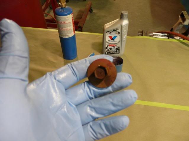

This is a simple Body Bolt Restoration it can be done for next to nothing. A few items are needed a propane torch, some motor oil, pliers, and a way to clean the bolts, you can use a wire wheel bead blast etc but they need to be clean. Remember to check the threads! here are the items needed.
This is our example bolt in need of a restoration.

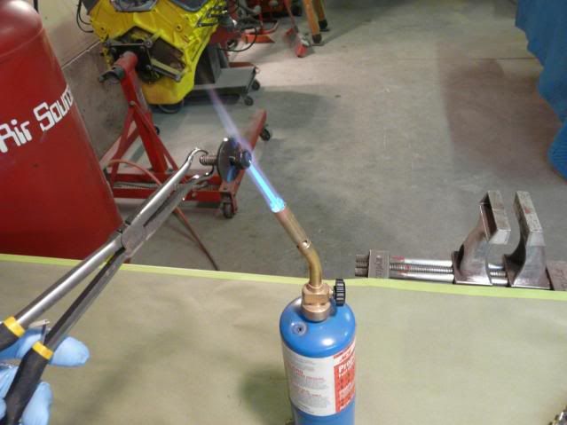

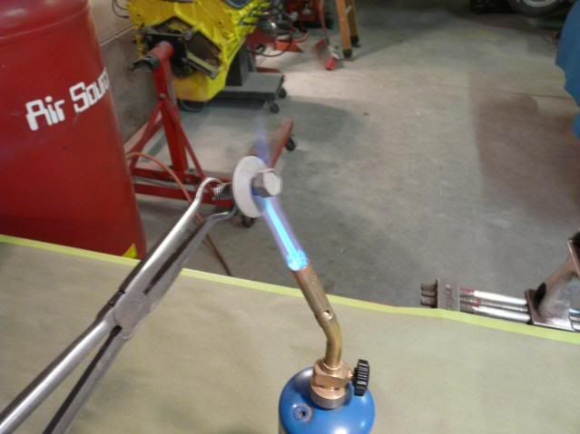

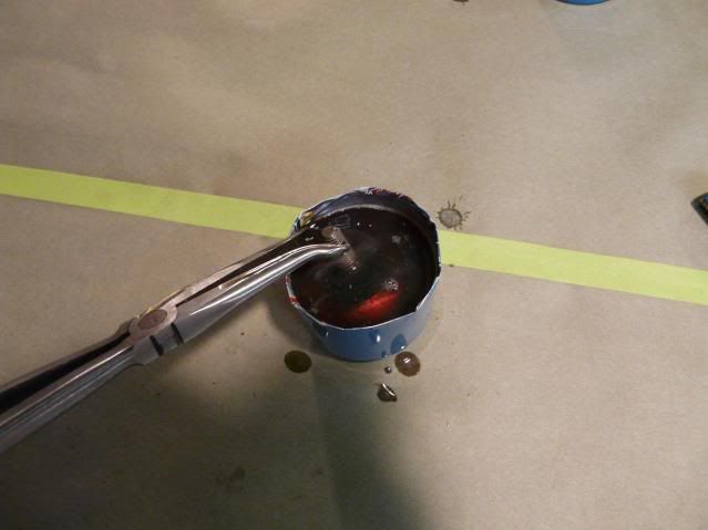

The next step is going to be heating the bolt, I like to use a propane torch, a actual cutting torch will heat way too fast and create a "gun blueing effect" heat the bolt to a goldish color first.

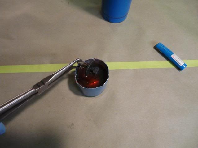

Next you want to soak the bolt in the oil.

Remove the bolt from the oil after about 30-45 seconds.
At this point I like to do the whole heating process over without removing the oil.

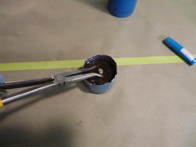

After you see the oil dissipate resoak the bolt for the last time in the oil.
Remove the bolt after 30-45 seconds.

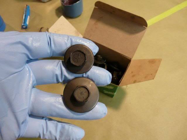

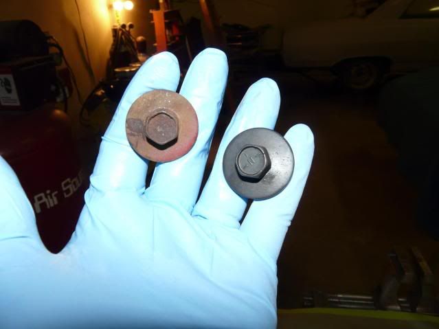

Let the bolt cool on its own, this is a before and after.
This a comparison with a new bolt out of the box, "upper bolt" and our restored original bolt lower.
