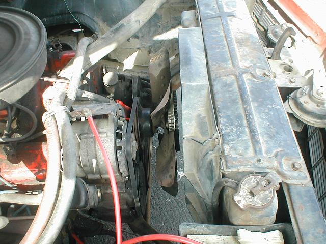

At the MCACN show in Chicago, I lost 2 points for my power steering reservoir cap. It's the metal cap with the ears, not the round plastic one. The judge looking at the motor said it was the only thing he found wrong under the hood. I was really surprised because that was something I was sure, was correct. Now I'm not sure. He kept saying it should have a black cap, and I thought he meant the round cap like the 70's have. So I started looking for a 69 survivor with power steering and couldn't find one. Question: What should a 69 L78 Chevelle power steering cap look like. Round, metal with ears, natural/nickle plated, or metal painted black?

I just found this in my archives, this is a low mile unrestored 69 SS. Looks like the cap has about as much paint as Rick's 6 banger.
