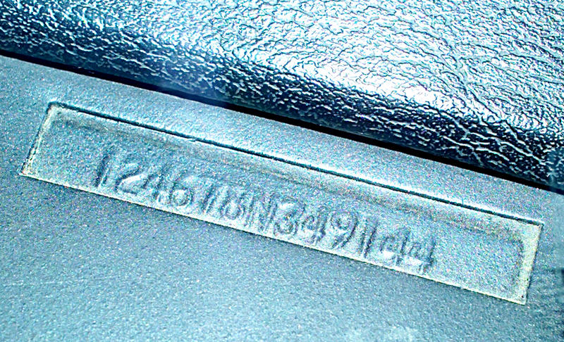

I was looking at egay and found this:
Chevrolet Camaro Cabrio 1968 BB 396/427 Yenko
http://cgi.ebay.de/Chevrolet-Camaro-Cabr...=item20ae129ea1
VIN
TRIM TAG
Current price:
EUR43.500,00
USD64.840.00
It´s a real Yenko????
Car is located ca. 113mls. away from me...
Jorge

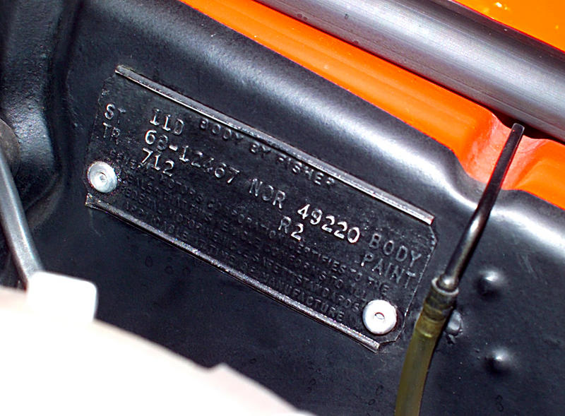

Looks like the only thing you have is his word that's it's a Yenko.
Doubtful.....
They went a little crazy and painted everything body color. Trunk, fenderwells, etc...
124678N349144

lousy job putting the trim tag back on as well! also a 69 yenko stripe on a 68 and it would have had a stinger hood, not a cowl hood

If a real '68 Yenko, where's his Y# tag?.
And 68's had a unique hood...it was the 67's that had the stinger style..
Not that they made any ragtops but '68 Yenkos were first Copo 9737 cars which have MM Trim Tags & 140 Speedos..
Being an export car it's possible it could've had an MM T'Tag which would've made things even more confusing!.
