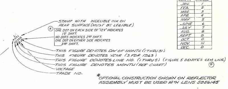

Default T-3 head light date code
Do T-3 headlight's have an actual date code on them? I know about the clear shield vs shield with lines. There are several numbers & letters cast in the glass.

Default Re: T-3 head light date code
They do,but they are ink stamped on the back and usually wear off.If you notice any,post what you see.
What's it's diameter?
That third line is the date code.
First character denotes the month.
second year..
third day of month.
I can only make out the 6,so most likely 1966.Can you make out the third line any better?

[/ QUOTE ] 6012 is a 7" round(large). I thought the bulbs with lines in the script are 68-71 so how could this be a 66? I have a 4002 small round low beam with lines that the ink stamp date line is clear and reads 15 0 8 so it must be day-year-month.
I've attached the decode sheet for the T-3 date stamps.
Pic
