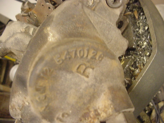

The two I took off my 70 camaro casting #s are Left # is 5470126 & r # is 5470125. I don't think these are org to the car. The disk hub is dated B 14 70. My car didn't have front brakes when it was ran back then.

I found that the correct casting numbers are, per Ron Norman, if anyone cares or wants to dispute:
6470128 rh
6470126 lh
Ron has a buddy who took these off of his original '70 L78

I still think they are 54 not 64, enclosed pic. 5470126

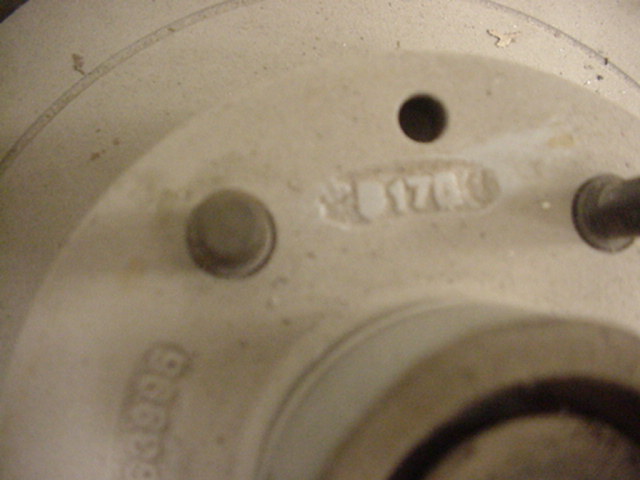

This one is dated B12 & the disc is dated B17 0

No,the "70" in the box number does not denote the year.That's just a coincedence.
I'm with Kim..that's the number 5.
