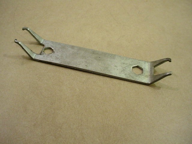

Looking for a source (hopefully local) for removing wiper arms from Chevelles, Novas, Camaros.
Thanks
Here is one offered by "KD" (part # 2039)...
Sam...
Attachments - The Supercar Registry 409809-Anco42-002.jpg 409808-Anco42-00.jpg

Sam it looks like this...
Mark

Thanks Mark - not sure how that tool is used. Can you explain?

I still have my Anco wiper tool I had back in the 60's.
John Brown
Old 07-03-2009, 03:01 AM
John Brown's Avatar
Location: South Bend, Indiana
Posts: 2,820
Thanks: 455
Thanked 510 Times in 243 Posts
Default Re: Wiper Arm Removal Tool
It has the number 42-00 hand etched on it.
No moving parts, the tool hooks over the arm itself, picks the end up off of the shaft and never touches any other part. It only takes one hand to use too.
John Brown
You stick that pointed end in the back of the wiper arm then lift up the spring to loosen it so you can remove the arm. A screw driver will do the same but since they made a tool I bought it and it works well. Mark
