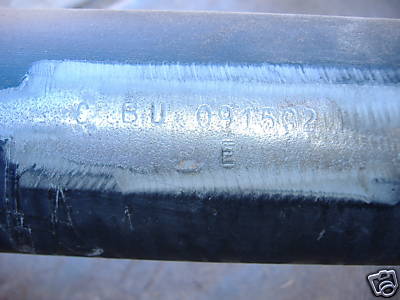

I have a June 1970 test in Super Stock and Drag Iluustrated on a L34 Nova that they state has a 3:73 twice in the article. I have to disagree with 3:55 as the lowest gear you could order. I have attached a pic of a "CBU" 12 bolt that looks legit also That only Novas would have as 69 Camaros did not use the "C" according to my 62-76 Chevrolet parts books. I feel the Silver Nova which was in the Dupont Registry a couple years ago is not legit. The homemade dual snorkel is a joke. I was also wondering about the Black one Legendary restored. Did they restore 2 Black ones an L78 and a L89? because I believe I have seen both. One with aluminum heads and one without. and 2 different POPs. Just my 2 cents.
