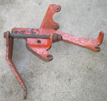

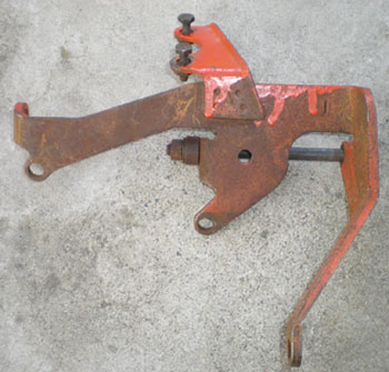

Hey Martin- I have a 68 375/396 i am gathering parts for- if your smog system is original- could you send me some pictures of the bracket that holds the pump- i am looking for one- thanks tony email [email protected]

I took some pictures today and will post them when I have time to get them off the camera and downsize them. I'll send them to you in a PM then.

Pic 1

Pic 2

The bolts I have for the elbow in the back of the pump are RSC, grade 5. The bolts for the diverter valve to the bracket have a triangle, grade 5. Is this what you have? The pump I have is dated 3457. Tower clamps all dated 4/67. This has been pieced together from 2 groups of parts.
If you could post a photo of the adjusting brace I would appreciate it. That's the one piece I have that might not be correct.
