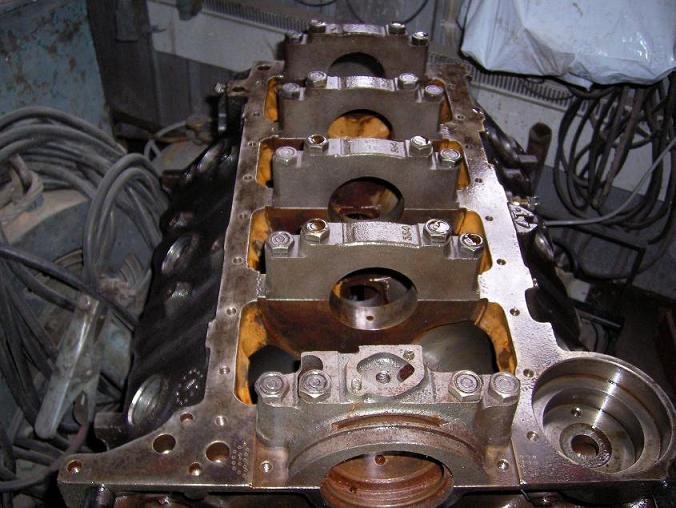

Found this block at ebay.
Is casting date from -67?
Black Panther ZL1 engine?

What are those marks on the deck above #3 and #7?

What ever that is it isn't a casting date. With the exception of ZL-1 Camaros #1 & #2 [which had pilot engines built in Flint] production blocks were cast in '69.
The dimpling on the deck is a crude attempt to achieve better head gasket sealing. Indicates a larger problem.
At second glance I'm not certain that is a production ZL-1 block. There is no snowflake and it does not appear to have provision for a mechanical fuel pump. Hmm...

Looks like a can am block??

Ok, I thought that those marks where after they trying to loose tension at the block.

Does not have the bolt-in cam plug either. Looks to me like someone ground off the Winters logo. We can fix that for the next owner. Done about two dozen so far. LOL.
I'm sure that this block won't pass a pressure test either. Nothing that $$$ can't fix.

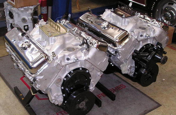

Here are two good ones!
Jerry
