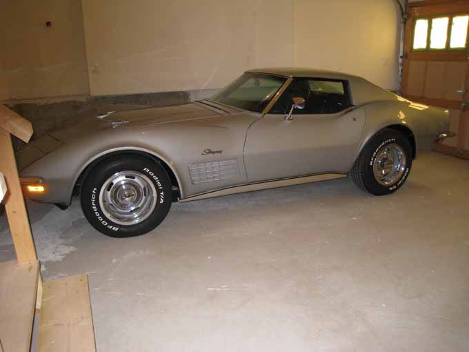

For you Northern folks that deal with snow in the Winter...do any of you park your daily driver in the garage with your Muscle Car during the Winter? If so, any ill affects?
I bought a mint '70 LS5 Corvette this past Summer and I am getting a lift next week to get it off the ground. However, I'm still hesitating about using the same garage (2 car bay) for my daily driver during the winter for fear that the moisture from any melting snow will corrode some of the undercarriage (it is a frame-off restored car). Thanks in advance for any advice

Dennis, unfortunately the garage is not heated as it's attached to the house. It will be on a 4 post lift though...
Here is one quick pic before I hit the sack
Mark
