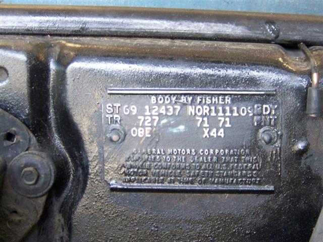

August date. Why is the body number low?

Body numbers were reset at Norwood at the beginning of August of 69.

My car is close to that one.
ST69 12437 NOR111140 BDY
TR 712 71 B PNT
09A X11D80
Do you have any more pictures of the car?

I got one dated 08C with a 101XXX trim Tag #
