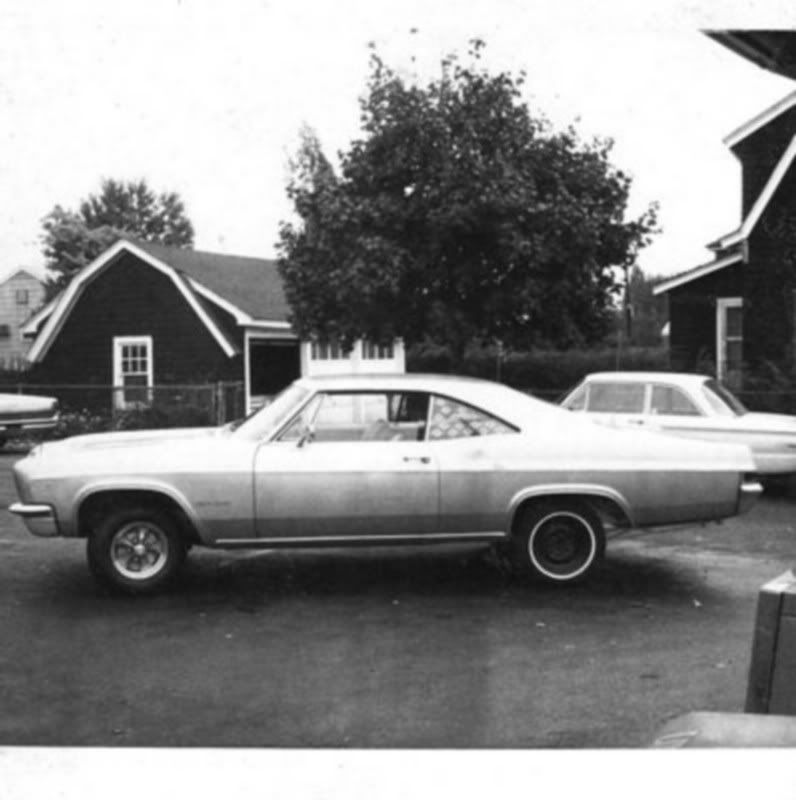

I had a '66 L-72 4 spd car back in the late sixties - When running slicks, besides wheel hop, I was having a
terrible time tearing out trailing arms and the transmission crossmember mounts.
I made a set of ladder bars and ran them backwards to the frame ends. This set up though unorthodox
combined with air bags in the rear springs solved my problem for quite some time.
The car set up high in the air Gasser style held together for a couple years of hard street/strip launches!

Hey Dog - got a close up of your rear quarter window? Looks like you collected a few stickers at the local tracks !!!!
