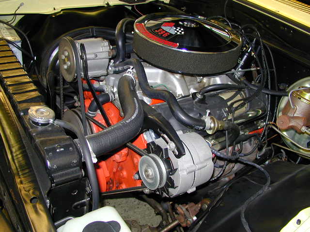

I thought the L78 wasn't available in the Chevelle until around April or May?
Beautiful car either way though.

Wouldn't count on an original block with that stamp pad.

Wheres the trim tag goop? Vin on trans matches window sticker but its not a 67 tranny should be p7xxxx not P1123

EX is the right code for a CA smog engine. Its supposed to have a pump. In that case they only made 19!! L78 67 Chevelles for CA. Didn't they build Chevelles in Fremont CA. Why would it come all the way from GA? Frank
Here is one built stamped T0705EX car was built 7C.
Smog like this...

Thats right, the early 4 bolt shallow groove pump.
