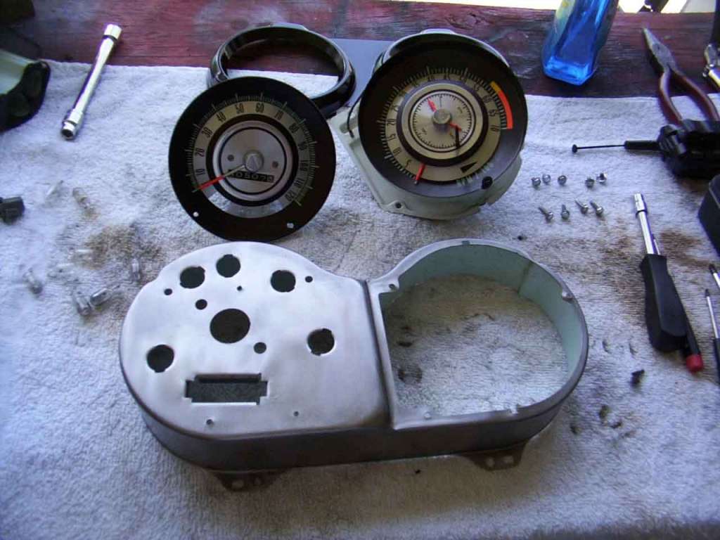

I restored my own.I took it all apart,then brushed the steel
parts with a soft wire wheel on the grinder . Make sure that you dont remove any dates as those dates are further proof of your cars build date.The painted surfaces
I cleaned with a chemical degreaser and then matched painted
the inside of the steel case.I mixed paints until I got the right colour.As far as repairing the gauges maybe someone else can help.I blasted the screws and then painted them the right colour. (stainless paint) also the steel
cover. the finnish came out real nice. take a look
PJ

another
