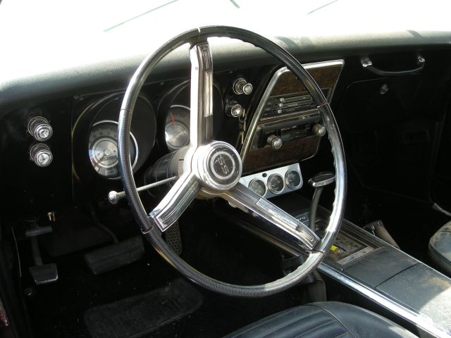

Here is a shot of int. with stewart warner gauge cluster about console.
