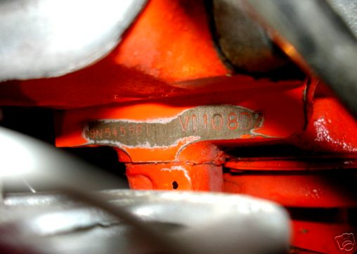

Another interesting Ebay item:
http://cgi.ebay.com/ebaymotors/VERY-RARE...1QQcmdZViewItem

Same car as discussed here:
https://www.yenko.net/ubbthreads/show...0/fpart/8/vc/1
Was for sale in MO. Hylton says when he looked at it, there was no sign of original drivetrain, and it had a big block. Now for sale in VA, still claiming to be numbers matching.
Would sure like an opinion from Kurt S. or Mark C. on that engine stamping.

Don't believe it is the same guy. Previous seller was in MO. The current seller is in VA. Just registered since April.
Since last auction, the car has grown a new hood, I think. Didn't it have the correct flat hood in the previous auction?
Is Kurt out there? How about Mark C? Would sure like their opinions on that engine stamping.
Lynn
Lynn,
There are stamping guys out there that can fool anyone and I mean anyone.
It is impossible to certify a COPO or Z/28 as authentic without verifying that it is not a rebody...
