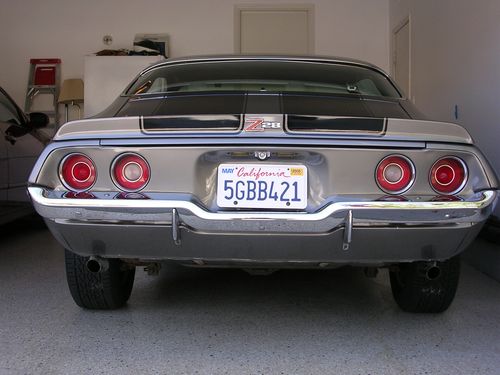

I'm in need of the two bolts and washers that hold the bottom of the bumper guards to the rear end panel on my '70 Z28. Thanks.

This is one thats done wrong a lot, the bolts look way to small for the brackets. S B C are the originals on my car, not sure how correct you want to be.

Jack, My rear valance has no holes, will I need self tapping bolts too? What type of washer is used? Rubber?

rear shot

www.amkproducts.com has similar if not the same 1/4"X 1" Bolt. I have seen a different head marking than Jack's above picture....so long as some G.M. headmark would be OK!
WELLNUT is/was brand of Valance nut of which AMK has on page 70 of catalog, but not sure if O.E.M. Washer useage appears to have been improvised at factory, as not captured or anything special

They are 1/4" and not 5/16"s ?

No self tapping bolts used, rear valance has a 1/4-20 (coarse) Nutsert on my car. I have seen cars with and without a black plastic or hard rubber washer against the paint. Unsure about this detail but no self tappers I'm quite positive.

So what do ya do, drill the valance? It looks like you can't get a nut behind the panel.(talk about a nut behind the wheel) I was told by a guy that ownes a few second gen cars that he uses self tapping. No wonder every other '70 or second gen Camaro has no rear bumper brackets... I really don't want in to be a mickey mouse deal. What a pain in the backside this has become. Thanks for the comments guys.
