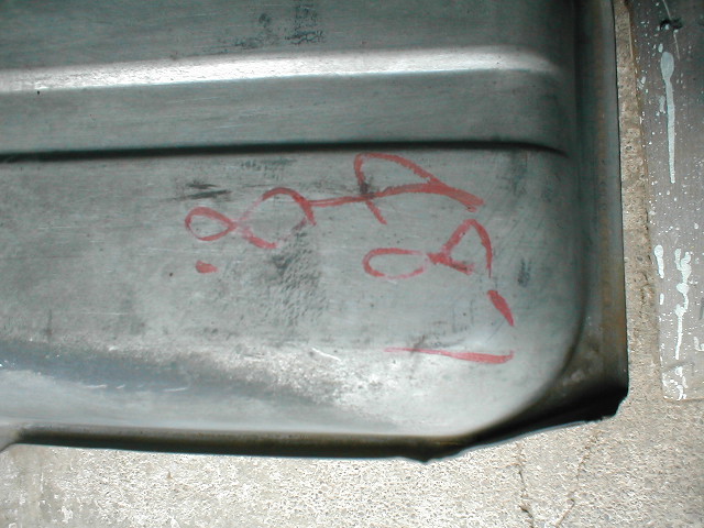

Did the Camaros get any insulation between the fuel tank and strap in 69? I know about the anti-squeak on the top if the tank but what went between the tank and strap on the bottom? I want to install my gas tank tonight but after going through some photos I am having second thoughts. Thanks!

Nothing.

Thank you Charley.
