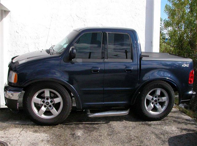

<font color="blue">Here's a picture of my F150.
Wild ride too ... </font>
