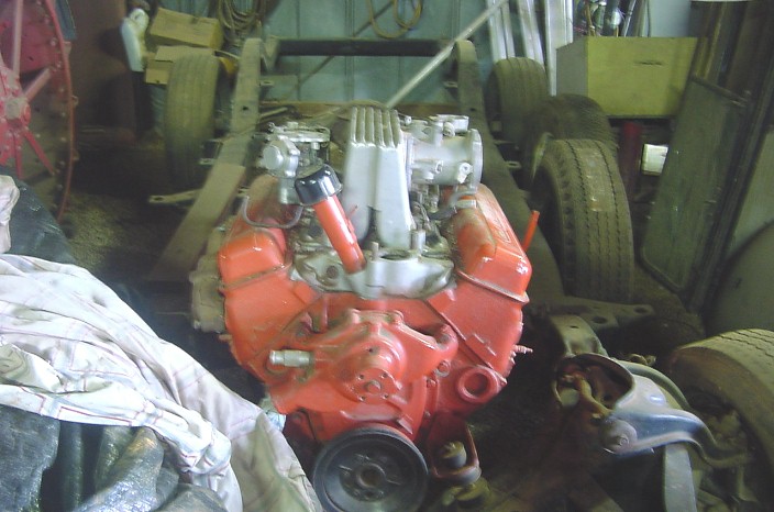

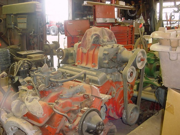

LOL I don't think you can get either of these cars from my son. He found them 15 yrs. ago and we have been waiting our time. However there are over 20 other cars involved plus a large barn full of parts. Check out the blown small block in the background of this pic.
