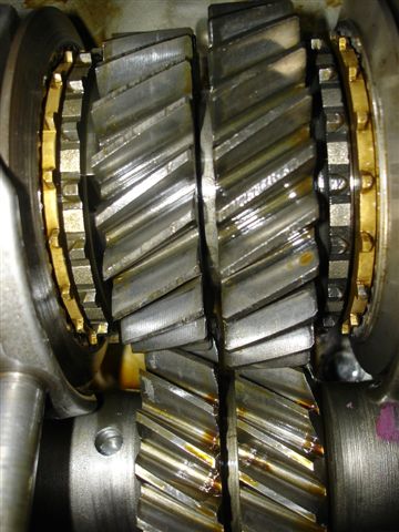

Gears
Anders Stålklint. After selling my COPO 9561 I´m now a "postman" with the main project being a 1966 327 2 dr sedan Chevy II. ![]() |
Looks like a borg warner from the oicture,side plate is corved on the bottom.
Bobby |
looks like a slick shifted ST-10 with every other tooth ground off the speed gears...Crash
Hey Crash... Did you ever hear of a crash box?
